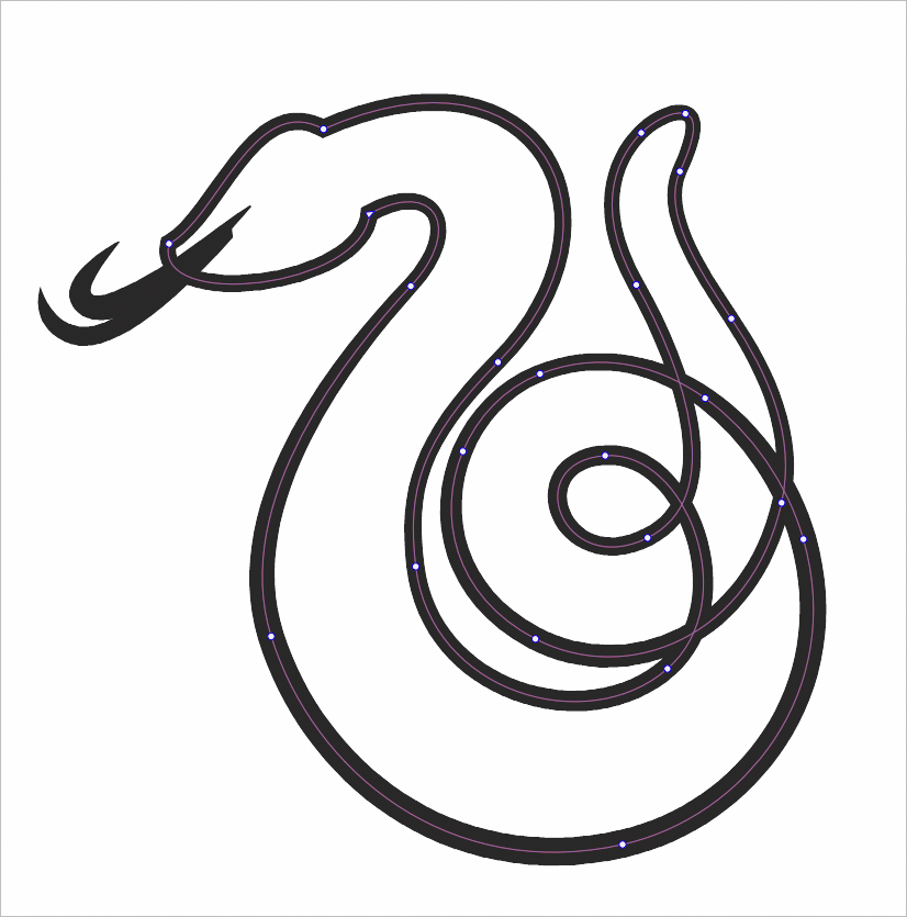

<?xml version="1.0" encoding="UTF-8"?><rss xmlns:dc="http://purl.org/dc/elements/1.1/" xmlns:content="http://purl.org/rss/1.0/modules/content/" xmlns:atom="http://www.w3.org/2005/Atom" version="2.0"><channel><title><![CDATA[How to expand and divide a single stroke overlapping object?]]></title><description><![CDATA[<p dir="auto">Interesting dilemma I ran into while using the pen tool to trace this snake - I drew it as one continuous path with the pen tool including where it overlaps itself toward the tail section. I drew out all the shapes to ensure the flow of the line made sense - plus I went back in after with the stroke width tool to adjust the tapering and thick to thin sections as I wanted them. Ordinarily at this point, I would expand the strokes and then use the divide boolean operation to divide where the overlap occurs and remove those sections.<br />
However, because the snake is essentially one path - if I expand the path, it auto merges into one shape, which makes sense.<br />
Is there an option to have it divide at overlapping points, even if it's the same stroke?</p>

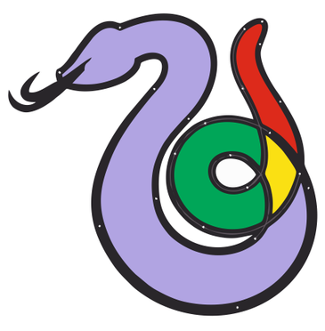

<p dir="auto">Thanks for the Info, a often overseen Tool.</p>
<p dir="auto">I try it, but i must say i dont know how to use it.<br />
Especially in the case of one intersecting Stroke<br />
like in Boldlines Example above.</p>
<p dir="auto">Found some infos and fiddle a bit<br />
and seems to get it to work in overlapping circles.</p>
<p dir="auto">But not if there is only one intersecting Stroke.<br />
Then it seems it works just like a normal fill<br />
will do.</p>

<p dir="auto">My thinking was that this would turn these areas<br />
into independent objects. Which it did.</p>
<p dir="auto">I created my result with the CorelDraw tracer, just to<br />
to show the method and the result. Because I don't know<br />
the VectorStyler tracer that well yet.</p>
<p dir="auto">Here is a screenshot of my result<br />
<img src="/forum/assets/uploads/files/1640160958129-snake-areas.png" alt="0_1640160903836_Snake-Areas.png" class=" img-fluid img-markdown" /></p>

<blockquote>
<p dir="auto">Is there an option to have it divide at overlapping points, even if it's the same stroke?</p>
</blockquote>
<p dir="auto">No such option. When the (single) stroke is expanded, it results in a single shape.</p>
<p dir="auto">I see that there is a variable width stroke, this makes it a bit more complicated, as it would be hard to cut at points to deal with overlapping parts.</p>
