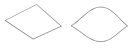

      I am trying to make an eye shape object with pen tool but I can't without using shape editor tool. Here is the recording. Here is the recording
      Doing Same in AD Recording
      Is this a bug?

        @Jayanta-Das Yes, there seems to be a problem to create cusp (sharp) corners with the Pen tool, at least when closing the path. I add this to the backlog.

          @Jayanta-Das Btw, you can do the same faster with the Path Sketch tool (shortcut: L):

              @Jayanta-Das Might be. But with the Path Sketch tool you can press Option to redo the last stroke. πŸ™‚

                could not resist to bring in my fifty cents
                made with the Pen Tool
                Here the Video
                Eye making in VS
                J 1 Reply Last reply Reply Quote 1

                      Talking about the pen tool... Let's say I want to create a drop shape. When I change a symmetry node into a cusp node using the tool bar (A), I still need to erase manually the tangents handles to obtain this result (B). I avoid the anchor point tool that gives me an unexpected and ugly result (C).
                      alt text
                      I also didn't find how to move separately the 2 handles of a node. In AD or AI I usually press "alt" while moving the single handle but it doesn't work here.
                        If the node is Symmetric and you want to change it to Smooth so that moving one of the control handles doesn't move the other in the opposite direction, select the control handle and press U.
                        If you want to change the node to Cusp, select it or any of its control handles and press L.
                        To change it to Symmetric, press Y.

                            @Devil-Dinosaur To void the result in (C) first convert all corner types to Cusp (before converting to lines).

                                      "L" and "Y" and the C conversion work fine πŸ‘
                                      I also use Firefox and Safari, that's why I assumed that everyone could see the picture.πŸ€”
                                      Fred.
                                        Another option is to use the option/alt key on the last point before you let go to complete the loop.
                                        Then you only need to adjust the line a little after
