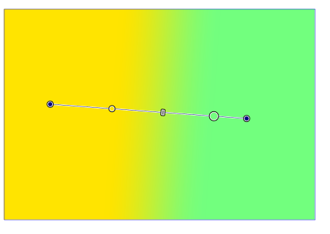

      But since it adds an intermediary color, it's not "the same result" β€” it's not the exact color of the closest color stop. Which might not be a problem sometimes, but sometimes it is.
      To recap, from my POV:
      1. If the current "detached handles" model stays, the handles should look visibly different from the color stops β€” smaller and let's say squared.
        Or maybe the color stops should be bigger.
      2. If the simpler "no visible" handles model is implemented, I hope there is a way to easily "unglue" the start or end color stop from its location.
        Not a must, but it's nice to be able to do this from the gradient tool, not only from a panel.
        And when one of the start or end color stops is moved, the handle that becomes visible still needs to look different in size and shape. (I hope everybody agrees on that).

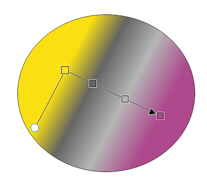

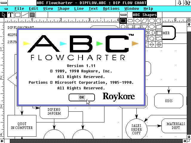

        But please for the love of all wonderful, no fugly symbols like CorelDRAW:
        Like arrows and squares. 😱 I am asking for less details. Then I'd rather stick to the current model
        CorelDRAW take me back to a distant fugly past with lines and noise ad libitum:
        🍏 macOS Sequoia Apple Silicon
          b77 @Ingolf
          @Ingolf Oh God… where did you find that last screenshot? πŸ˜‚
          Upvoted anyway. πŸ™‚
          If CDR would keep those squares rotated with the gradient angle, it wouldn't look terrible. But of course it would look much better with round color stops. πŸ‘
          • IngolfI Offline
            Ingolf @b77
            @b77 said in Usability issue when drawing gradents (.054):
            I don't know what weirdo that posted it on the Internet, but it was disturbingly easy to find. πŸ˜‚
            Not great, not terrible. ☒

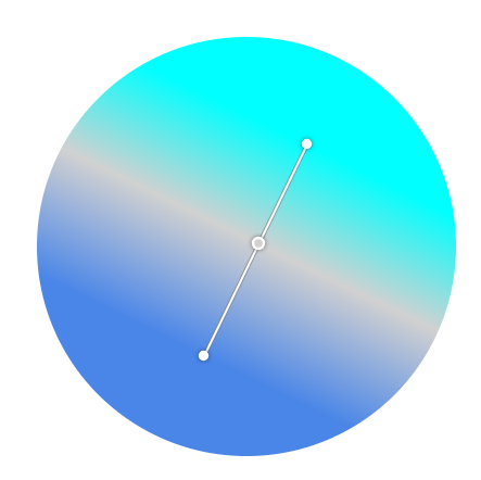

            ... I think Gravit, Affinity and Amadine did it just beautifully and that there is not reason to try to invent own logic and design. Also for the sake of easy adaption for newcomers.
