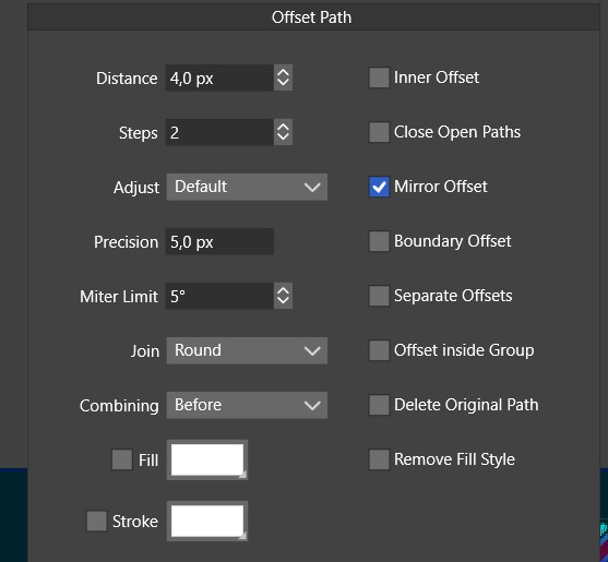

      I did an offset path & change the object colour. I would like to repeat these steps on other shapes without going again in the setup. I've tried the 'picker' tool without succes. I'm certain there is a way to do it in VS.

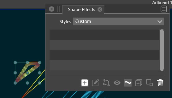

        VectorStyler @B-Vs-V
        @Pat The easiest way is to select the effects in the Shape Effects panel, copy (Control+C) select the other object, click inside the Shape Effects panel and paste (Control+V).
        The Shape Effect Picker tool (last among the picker tools), should also do this (works here): select the object to change, select the shape effects picker tool and click on the object with the effect.
        Another way: select the object with the effect, select Edit -> Attributes -> Copy Shape Effect, then select the other object and Edit ->Attributes -> Paste Shape Effect.
        BTW: Blend is not a shape effect, so for that these will not work, but it should work for "live" offset path.
        B 2 Replies Last reply Reply Quote 0

          'Shape effect Picker Tool' :
          • with the left one, I can copy the colour
          • with the second, I only partially get the offset path
          = I get nothing with the two last ones.

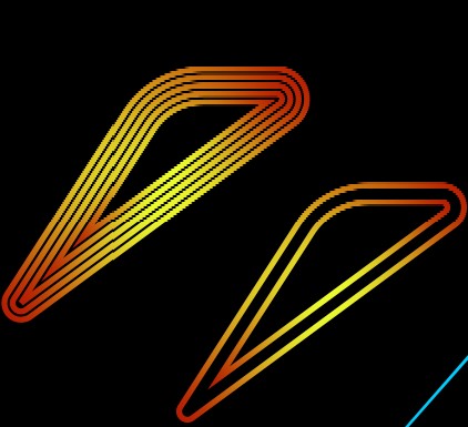

                  Subpath @VectorStyler
                  @VectorStyler said in How to apply effects to other objects?:
                  @Pat I will try to replicate this on Windows.
                  i tryed it allready on Win 10
                  and everthing works as expected
                  Used Shape Effect Picker for Offset Effect
                  and Styler Picker for Gradient.
                  B 2 Replies Last reply Reply Quote 1

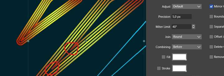

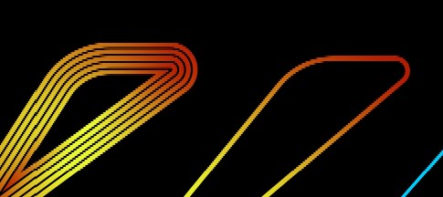

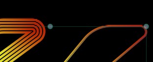

                    @VectorStyler I think there is still enough space to get sharp pointed edges but no way by modulating the miter limit... another way ? Thanks.

                      @Subpath maybe different due to the offset path setup ? I've tried many times but to no avail.

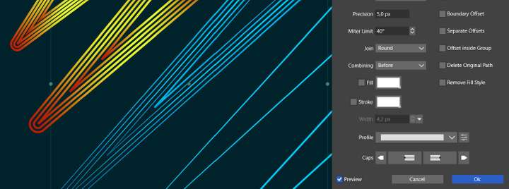

                      @VectorStyler also, when I want to change the stroke profil through the offset path, it didn't.
                                  @Pat said in How to apply effects to other objects?:
                                  Set the Miter Limit value to very small (5 or less).
                                  • B Offline
                                    B-Vs-V @VectorStyler
                                    @VectorStyler I've tried all the possible values ☺
