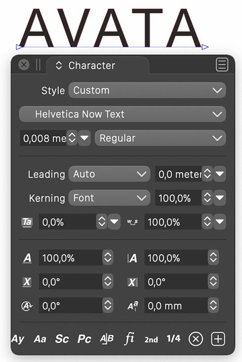

Here is the screenshot with Helvetica Now Display Regular.<br />
(the fonts were installed into macos, not with VS font manager).</p>
</blockquote>
<p dir="auto">This happens with any of the 48 fonts belonging to Helvetica Now family (it consist of Display, Text and Micro basic families and then several weights in straight and italic style from each). Here is a comparison of using the same font in VectorStyler and Affinity Publisher:</p>
<p dir="auto"><img src="/forum/assets/uploads/files/1616419521733-helvatica_now_text_opentype_ps-resized.jpg" alt="0_1616419514664_helvatica_now_text_opentype_ps.jpg" class=" img-fluid img-markdown" /></p>
<p dir="auto">In addition, when I export this page to PDF, I get a completely empty page, yet all fonts are embedded (I'll send it in email for your examination).</p>
<p dir="auto">Can you confirm that you get metric kerning with the PS flavor (and not TrueType flavor) of this font on Big Sur 11.1 M1 version of VectorStyler? (The font comes probably in both flavors and it may be that the error only happens with the PS flavor...)</p>

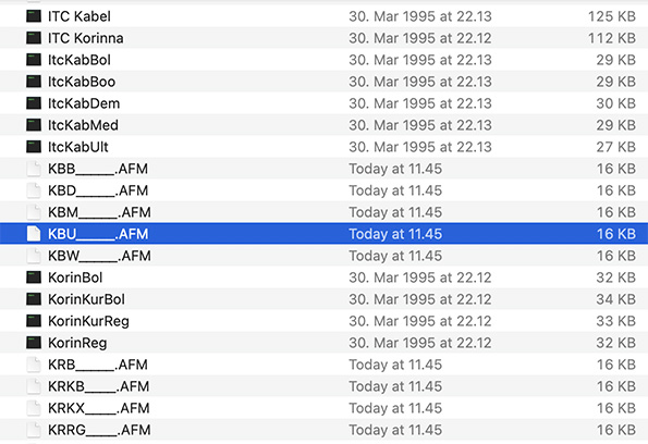

<p dir="auto">(old) Type 1 (PFB) fonts can only be used correctly when added with the internal font manager of VS (i.e. will not show up in the system). if the afm file is also copied into macOS /Fonts folder then it should work.</p>
</blockquote>
<p dir="auto">I have tried to add them using the VS internal font manager, both by indicatiing the folder location (home &gt; Library &gt; Fonts), or trying to pick individual Type 1 files, but none of the Type 1 files work correctly on my system (BigSur 11.1 and M1 version of VS).</p>
<p dir="auto">I even placed the original AFM files from Adobe in the same folder but it does not help. These fonts are from Adobe FontFolio 8.</p>
<p dir="auto"><img src="/forum/assets/uploads/files/1616410083821-type1_on_disk_home_library_fonts.jpg" alt="0_1616410082584_type1_on_disk_home_library_fonts.jpg" class=" img-fluid img-markdown" /></p>
<p dir="auto">They have been installed with Font Book and as said still work without problems with Adobe Photoshop 2021, QuarkXPress 2018 and Affinity apps (where they are only partially supported and do not support metrics based kerning).On Adobe, Quark and system kerning with Type 1 works just fine (and does not require AFM files):</p>
<p dir="auto"><img src="/forum/assets/uploads/files/1616409438817-type1_system_bigsur_m1.jpg" alt="0_1616409437805_type1_system_bigsur_m1.jpg" class=" img-fluid img-markdown" /></p>
<p dir="auto">On Windows Type 1 fonts seem to work ok with VS, including kerning, so I have them in Windows\Fonts and they operate just fine (no need to use VS Font Manager on Windows).</p>

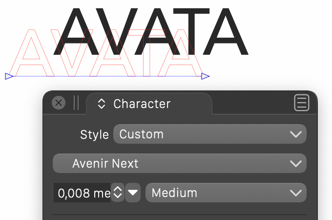

<p dir="auto">As for kerning with metrics, at least all fonts belonging to Monotype Helvetica Now show this problem:</p>
<p dir="auto"><img src="/forum/assets/uploads/files/1616092325059-helvetica_now_text_regular.jpg" alt="0_1616092323935_helvetica_now_text_regular.jpg" class=" img-fluid img-markdown" /></p>
<p dir="auto">The same font is correctly metric kerned in Photoshop:</p>
<p dir="auto"><img src="/forum/assets/uploads/files/1616092115299-helvetica_now_text_regular_ps.jpg" alt="0_1616092114385_helvetica_now_text_regular_ps.jpg" class=" img-fluid img-markdown" /></p>

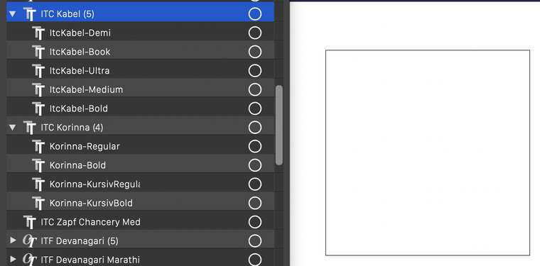

Strange! As this is how things look on my MacBook Air (M1 on Big Sur 1.1, latest VS RC1):</p>
<p dir="auto"><img src="/forum/assets/uploads/files/1616088184234-type1onm1_02-resized.jpg" alt="0_1616088182986_type1onM1_02.jpg" class=" img-fluid img-markdown" /></p>
<p dir="auto">As you can see, not Type 1 symbols (as on Windows), but as if these were TrueTypes. All these fonts come from old Adobe sources and they validate with all green in Font Book. They also operate perfectly in Adobe Photoshop 2021 (latest M1 build):</p>

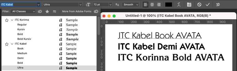

<p dir="auto"><img src="/forum/assets/uploads/files/1616088393701-type1onm1_01-resized.jpg" alt="0_1616088392401_type1onM1_01.jpg" class=" img-fluid img-markdown" /></p>
<p dir="auto">As can be seen, they also get their Adode font symbol in Photoshop.</p>
<p dir="auto">Note that I do not have any font manager on my computer. Could this explain this?</p>
