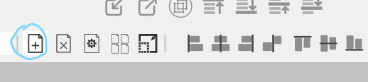

<li>select the <strong>Artboard Editor</strong> tool from the Toolbox and click on your artboard.</li>
<li>Size it deliberately different than your starting artboard.</li>
<li>With the artboard still selected, in the Context Menu at the top, click on the icon with the tooltip, "Create a new artboard using the format of the selected artboard, circled below in blue:<br />
<img src="/forum/assets/uploads/files/1705463722091-8b395a4e-b410-489b-9b17-cec44a458c9a-image.png" alt="0_1705463721927_8b395a4e-b410-489b-9b17-cec44a458c9a-image.png" class=" img-fluid img-markdown" /></li>
</ol>
<ul>
<li>
<p dir="auto">Outcome: The new artboard is the size of the starting artboard.</p>
</li>
<li>
<p dir="auto">Expected Outcome:  The new artboard should be the same size of the newly sized and still selected artboard.</p>
</li>
<li>
<p dir="auto">Extra Info:  If you change the artboard size in the Document Setup window, the button will use that size, not the selected artboard size.</p>
</li>
