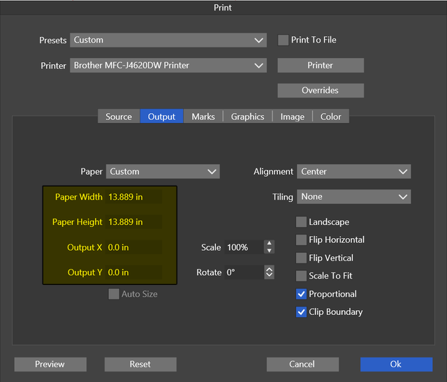

<p dir="auto">I will try to replicate the printing issue.</p>
<blockquote>
<p dir="auto">I do not know what these settings are for... they're not accurate as to the capabilities of the printer itself.</p>
</blockquote>
<p dir="auto">This is the paper size for VS to print on, can overwrite the default paper size.</p>

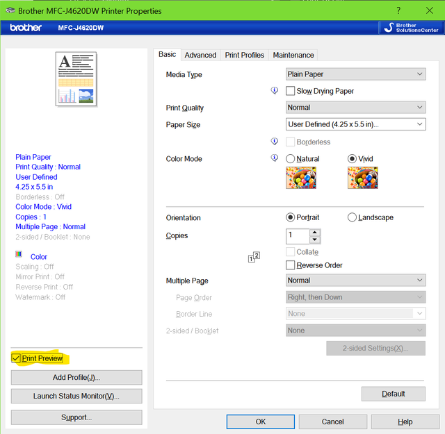

<p dir="auto">I did record that session. I have the files and also will include a screenshot of the printer make.</p>
<p dir="auto">Normally with this printer, I setup everything from the print driver. If I enable "Print Preview" in Brother, it will always show the preview for confirmation before the print job is actually pushed to the printer. For some reason, in VS this setting is ignored, which might indicate there's some communication missed there.</p>
<p dir="auto"><img src="/forum/assets/uploads/files/1716692811397-240525_printer-dialog-box.png" alt="0_1716692810868_240525_printer-dialog-box.png" class=" img-fluid img-markdown" /></p>
