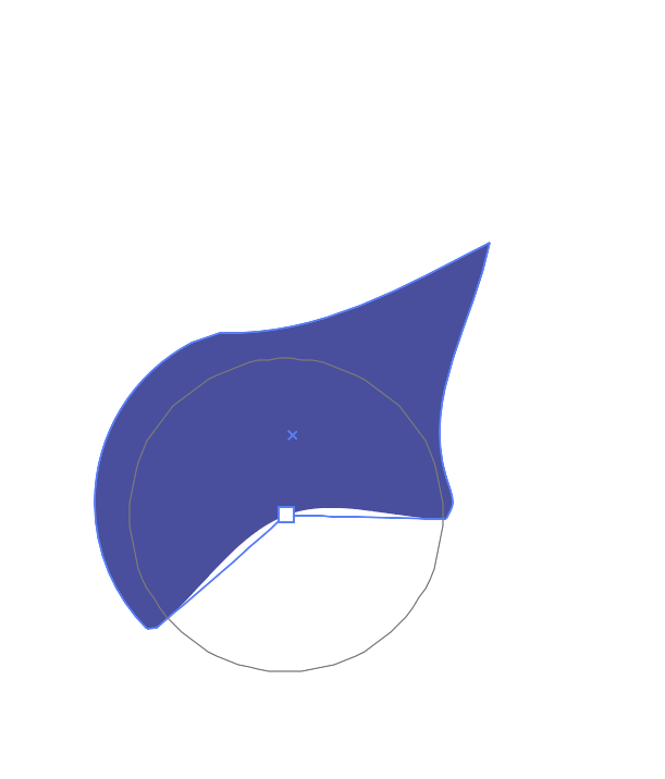

<?xml version="1.0" encoding="UTF-8"?><rss xmlns:dc="http://purl.org/dc/elements/1.1/" xmlns:content="http://purl.org/rss/1.0/modules/content/" xmlns:atom="http://www.w3.org/2005/Atom" version="2.0"><channel><title><![CDATA[Pucker tool like functionality.]]></title><description><![CDATA[<p dir="auto">Is it possible to have tool or functionality similar to pucker tool (deflates objects shape by moving control points towards the cursor, kinda opposite to circular bump tool) in illustrator? It's helpful in illustration works. May be it's possible to achieve the same with already existing tools by changing some settings and I havent figured it how.</p>

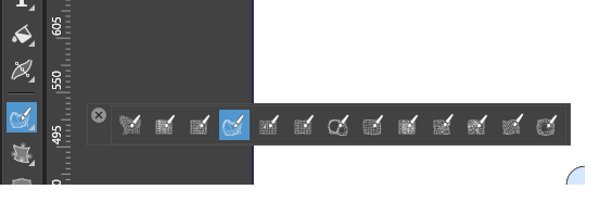

]]></description><link>https://www.vectorstyler.com/forum/post/26690</link><guid isPermaLink="true">https://www.vectorstyler.com/forum/post/26690</guid><dc:creator><![CDATA[VectorStyler]]></dc:creator><pubDate>Sun, 04 Aug 2024 07:33:04 GMT</pubDate></item><item><title><![CDATA[Reply to Pucker tool like functionality. on Sun, 04 Aug 2024 00:49:20 GMT]]></title><description><![CDATA[<p dir="auto"><a class="plugin-mentions-user plugin-mentions-a" href="/forum/user/subpath" aria-label="Profile: Subpath">@<bdi>Subpath</bdi></a> <a class="plugin-mentions-user plugin-mentions-a" href="/forum/user/vectorstyler" aria-label="Profile: vectorstyler">@<bdi>vectorstyler</bdi></a> Thanks for the reply. I couldn't figure out settings to get similar functionality of the pucker tool. ( eg <a href="https://www.youtube.com/shorts/I0J5roYfHLQ" rel="nofollow ugc">https://www.youtube.com/shorts/I0J5roYfHLQ</a>)</p>

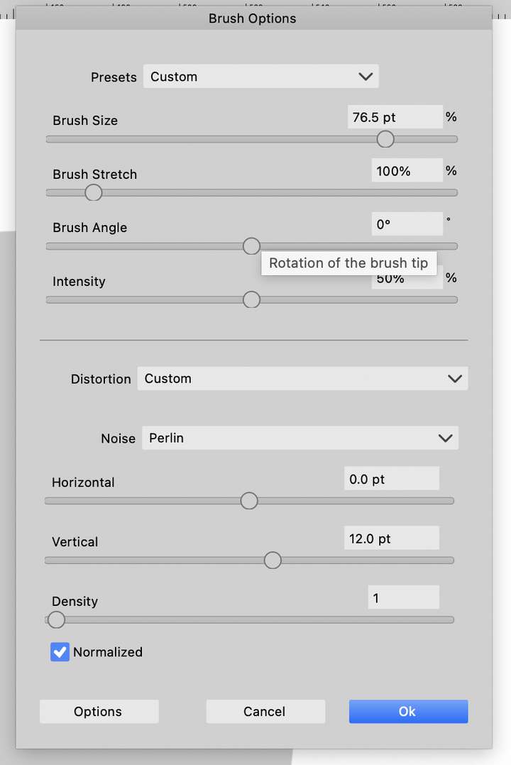

<p dir="auto">Options in VS brush tool .</p>
<p dir="auto"><img src="/forum/assets/uploads/files/1722732492928-03cec1a5-7c4b-46d4-891c-835f2ef602c5-image-resized.png" alt="0_1722732490987_03cec1a5-7c4b-46d4-891c-835f2ef602c5-image.png" class=" img-fluid img-markdown" /></p>
<p dir="auto">Any help appreciated, Thanks</p>

<p dir="auto">look here, double click on the Tool<br />
to change the size and to get further settings<br />
<img src="/forum/assets/uploads/files/1722711006222-pucker-tool.png" alt="0_1722710915600_Pucker Tool.png" class=" img-fluid img-markdown" /></p>
