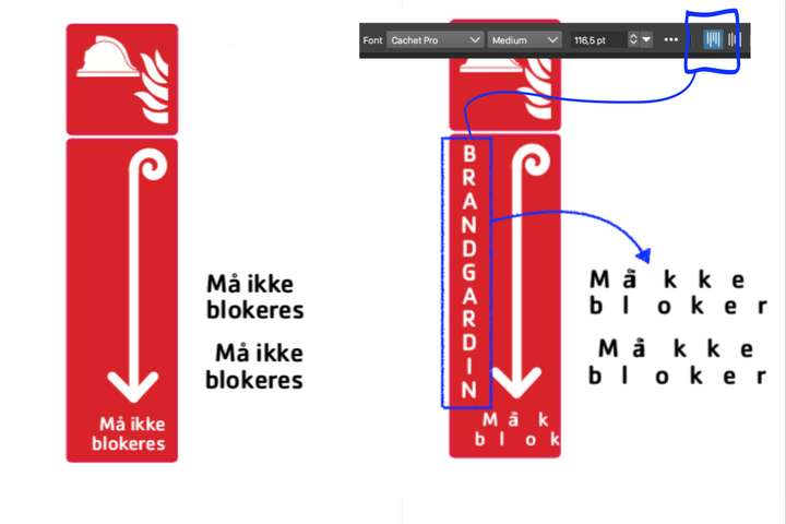

<?xml version="1.0" encoding="UTF-8"?><rss xmlns:dc="http://purl.org/dc/elements/1.1/" xmlns:content="http://purl.org/rss/1.0/modules/content/" xmlns:atom="http://www.w3.org/2005/Atom" version="2.0"><channel><title><![CDATA[Pdf exports messed up type]]></title><description><![CDATA[<p dir="auto">An old problem goes on. I have reported similar issue earlier this year: Have I missed a setting or is it the (still) same bug?</p>
<p dir="auto"><a href="/forum/assets/uploads/files/1722850127643-font-pdf-problem.zip">0_1722850125507_font-pdf-problem.zip</a></p>
<p dir="auto"><img src="/forum/assets/uploads/files/1722850503904-cfc89502-e127-4bdd-b76a-eb1edcb510d3-billede-resized.png" alt="0_1722850502853_cfc89502-e127-4bdd-b76a-eb1edcb510d3-billede.png" class=" img-fluid img-markdown" /></p>

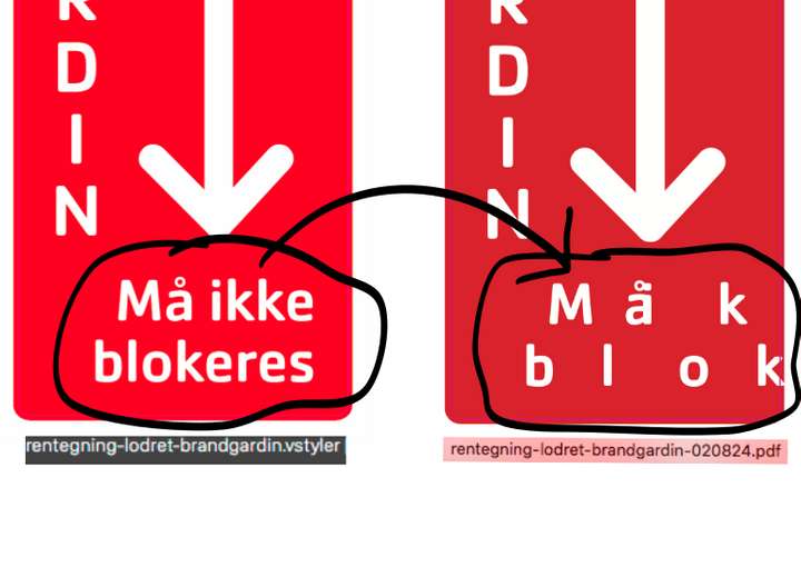

]]></description><link>https://www.vectorstyler.com/forum/post/26729</link><guid isPermaLink="true">https://www.vectorstyler.com/forum/post/26729</guid><dc:creator><![CDATA[VectorStyler]]></dc:creator><pubDate>Thu, 08 Aug 2024 15:20:42 GMT</pubDate></item><item><title><![CDATA[Reply to Pdf exports messed up type on Thu, 08 Aug 2024 13:33:08 GMT]]></title><description><![CDATA[<p dir="auto">I have figured out, that setting text in the document aligned vertical mess up other text objects with normal alignment when exported to pdf.</p>
<p dir="auto"><a href="/forum/assets/uploads/files/1723123598133-rentegning-lodret-brandgardin-02.vstyler">0_1723123597103_rentegning-lodret-brandgardin-02.vstyler</a></p>
<p dir="auto"><img src="/forum/assets/uploads/files/1723123962158-5a0cee90-e15a-4676-9465-dc64e6f7a3a4-billede-resized.png" alt="0_1723123960804_5a0cee90-e15a-4676-9465-dc64e6f7a3a4-billede.png" class=" img-fluid img-markdown" /></p>

]]></description><link>https://www.vectorstyler.com/forum/post/26699</link><guid isPermaLink="true">https://www.vectorstyler.com/forum/post/26699</guid><dc:creator><![CDATA[Raaskot]]></dc:creator><pubDate>Mon, 05 Aug 2024 12:29:34 GMT</pubDate></item><item><title><![CDATA[Reply to Pdf exports messed up type on Mon, 05 Aug 2024 10:56:11 GMT]]></title><description><![CDATA[<p dir="auto"><a class="plugin-mentions-user plugin-mentions-a" href="/forum/user/raaskot" aria-label="Profile: Raaskot">@<bdi>Raaskot</bdi></a> Opened a bug on this. Is this opened in preview? or reimported into VS?</p>
]]></description><link>https://www.vectorstyler.com/forum/post/26698</link><guid isPermaLink="true">https://www.vectorstyler.com/forum/post/26698</guid><dc:creator><![CDATA[VectorStyler]]></dc:creator><pubDate>Mon, 05 Aug 2024 10:56:11 GMT</pubDate></item></channel></rss>
