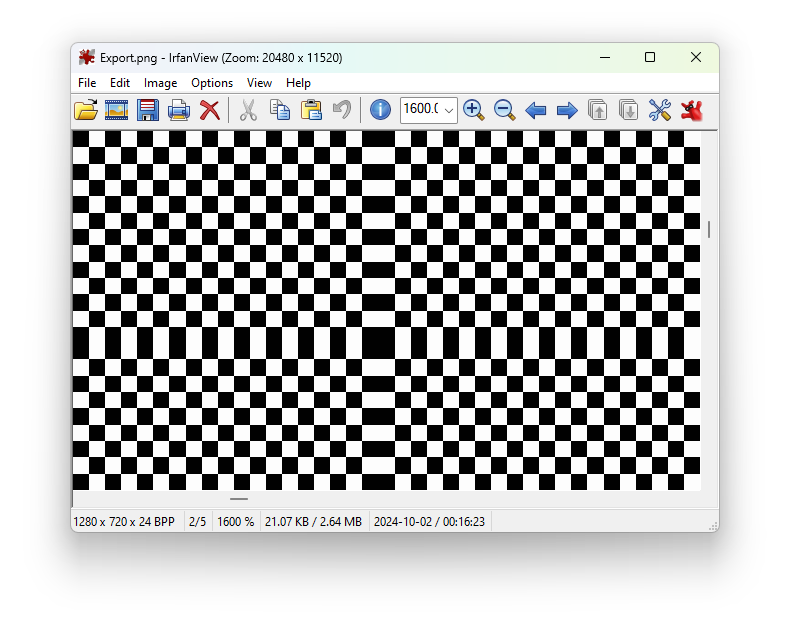

<p dir="auto">I import this image, a 1280×720 PNG image of a 1×1 pixel checkboard pattern, to a VS document. The first thing I noticed is that the image is 33% larger than expected, even though the PNG file and the VS document are both set to 96 dpi.</p>
<p dir="auto">I then manually match the image size to the canvas, and exported the image. And I got this:<br />
<img src="/forum/assets/uploads/files/1727801102000-export-resized.png" alt="0_1727801100935_Export.png" class=" img-fluid img-markdown" /></p>

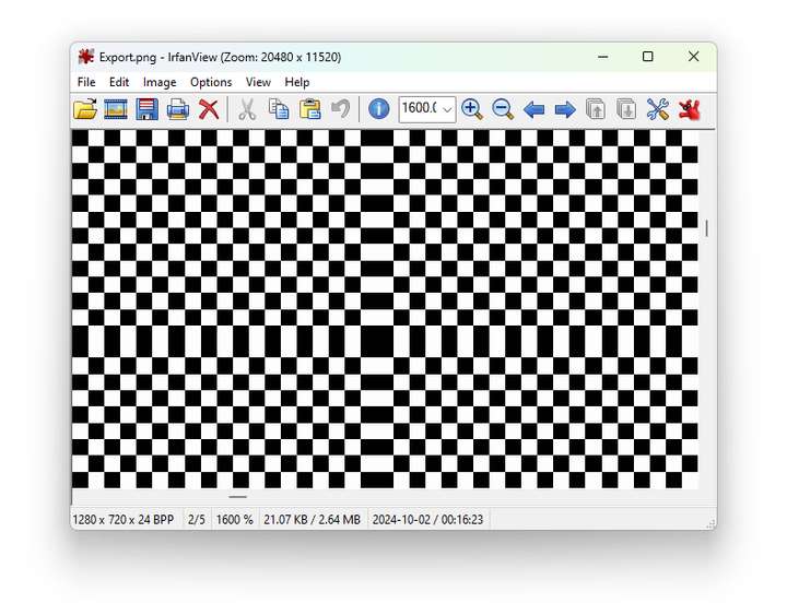

<p dir="auto">Zoomed in:<br />
<img src="/forum/assets/uploads/files/1727801163041-zoomin-resized.png" alt="0_1727801162449_ZoomIn.png" class=" img-fluid img-markdown" /></p>
<p dir="auto">Yep. Misalignment.</p>

<p dir="auto"><a href="https://stackoverflow.com/questions/44949926/preferred-value-to-encode-96-dpi-within-png" rel="nofollow ugc">https://stackoverflow.com/questions/44949926/preferred-value-to-encode-96-dpi-within-png</a></p>
<p dir="auto">And if I export a PNG file from VectorStyler, the resulting file will have a resolution of 3779 pixel per metre.</p>
<p dir="auto">Now I'm inclined to think that VS is working as intended in my scenario, and the rounding error is unavoidable. Still curious about my first case with a PNG file with unspecified dpi though. If I import a file of a specific pixel dimension, force it to scale to that dimension and export to a PNG of that same dimension, shouldn't the resulting image still be one-to-one in terms of pixel data?</p>

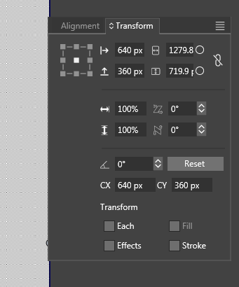

<p dir="auto"><strong>EDIT 2</strong>: But the Transform panel in VS says its dimension is 1279.8 by 719.9 px.<br />
<img src="/forum/assets/uploads/files/1727805568196-2a4da061-f837-47ad-9da9-28df96c81c73-image.png" alt="0_1727805567739_2a4da061-f837-47ad-9da9-28df96c81c73-image.png" class=" img-fluid img-markdown" /></p>
