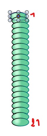

<?xml version="1.0" encoding="UTF-8"?><rss xmlns:dc="http://purl.org/dc/elements/1.1/" xmlns:content="http://purl.org/rss/1.0/modules/content/" xmlns:atom="http://www.w3.org/2005/Atom" version="2.0"><channel><title><![CDATA[History issue with cloned objects (?)]]></title><description><![CDATA[<p dir="auto">Simple object with a colour gradient, I've moved 20 cloned objects (Object --&gt; Move...). When I change the shape of the original object, alignment is off:</p>
<p dir="auto"><img src="/forum/assets/uploads/files/1729698401138-b1.jpg" alt="0_1729698400062_b1.jpg" class=" img-fluid img-markdown" /></p>

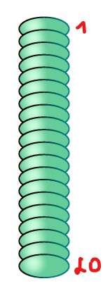

<p dir="auto">when I go back in history, it is missing:</p>
<p dir="auto"><img src="/forum/assets/uploads/files/1729698432345-b2.jpg" alt="0_1729698431752_b2.jpg" class=" img-fluid img-markdown" /></p>

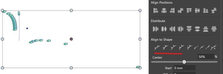

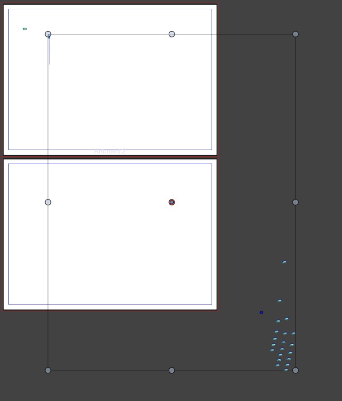

<p dir="auto">It calculates the movement and rotation of each clone relative to its original. But the original will be transformed by then.<br />
The effect is the accumulation of two transforms (wrong) with a wrong rotation center.<br />
I will fix this in the next build: the alignment tool has to take into account that the objects are clones.</p>
<p dir="auto">A similar thing will occur with aligning sizes, or when working with references.</p>
]]></description><link>https://www.vectorstyler.com/forum/post/27503</link><guid isPermaLink="true">https://www.vectorstyler.com/forum/post/27503</guid><dc:creator><![CDATA[VectorStyler]]></dc:creator><pubDate>Thu, 24 Oct 2024 07:44:15 GMT</pubDate></item><item><title><![CDATA[Reply to History issue with cloned objects (?) on Thu, 24 Oct 2024 06:31:43 GMT]]></title><description><![CDATA[<p dir="auto"><a class="plugin-mentions-user plugin-mentions-a" href="/forum/user/vectorstyler" aria-label="Profile: VectorStyler">@<bdi>VectorStyler</bdi></a> Although they are clones, I don't understand the chaotic distribution of objects:</p>
<p dir="auto"><img src="/forum/assets/uploads/files/1729751486586-b1-resized.jpg" alt="0_1729751486374_b1.jpg" class=" img-fluid img-markdown" /></p>
<p dir="auto"><img src="/forum/assets/uploads/files/1729751493082-b2-resized.jpg" alt="0_1729751493371_b2.jpg" class=" img-fluid img-markdown" /></p>

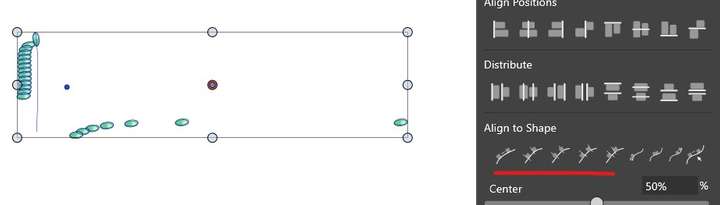

<p dir="auto"><img src="/forum/assets/uploads/files/1729700485539-b3.jpg" alt="0_1729700484610_b3.jpg" class=" img-fluid img-markdown" /></p>
