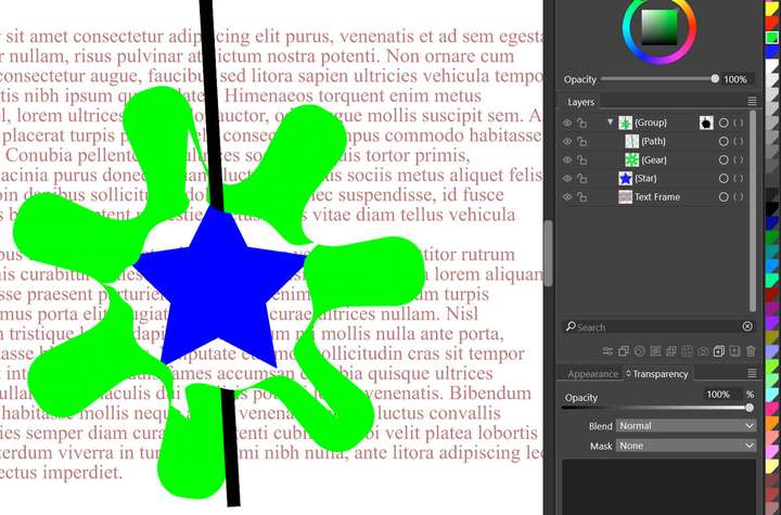

    Guys, I did it! Something I have been struggling to do in Illustrator, Affinity… I did it in VectorStyler 1.3. It works even if you group lines (curves, paths), shapes.
    You can think of it as a non‑destructive 'see through' mask workflow.
    • create a line and a shape (in my case I created a straight line and a gear shape) → {group} them in a layer
    • create another layer under the previous {group} layer with an object (I made a blue star) which will be "revealed" by the 'see through' mask object (hint: the mask will be of a type 'drawing' → important!)
    • select the {group} layer (with the paths, lines, gear shape in it), find the Transparency panel and in its Mask drop‑down menu select the type of the mask to be a 'Drawing' → (you get into 'isolation mode') now draw your desired shape to act a 'see through' tunnel and fill it with full black colour (other range besides full black means semi-transparent final effect)!
    • click outside the drawn (drawing) object to close 'isolation mode'
    • you can edit the 'drawing' shape at any time if you right click on the {group} layer (it has a mask icon) and select Edit mask (do not go to blend mode, leave it be or Normal)
    Swoosh! You get the 'see through' effect over the {group} and see the star!
    You can now select the {group} and the star and group them, so they can be moved together. Maybe possibly convert them to a Symbol… you get the idea. Maybe add some 'text frame', send it behind (under all) you name it!
    Unfortunately, if you then right click the {group} layer and select Mask type → None, you will loose the shape (drawing) you had as a mask. Maybe a good idea would be to only make it invisible and make another mask layer within the 'isolation mode' you are in (I made a spiral)!

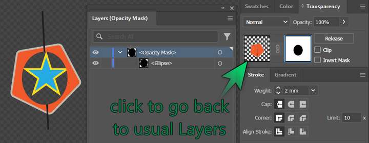

  • Aha, seems Illustrator 2025 can do it as well.
    Use the Transparency panel. Select the group and in Transparency panel click Mask. Then Alt+click the mask icon (white field) in the panel and create black shape there (you can create many shapes, hide, move them, in the Layer mask panel that opens). No need to invert or clip.
    Illustrator zooming is so sluggish… it is painful. So far Affinity and Inkscape are best regarding zooming with the mouse scroll wheel.
