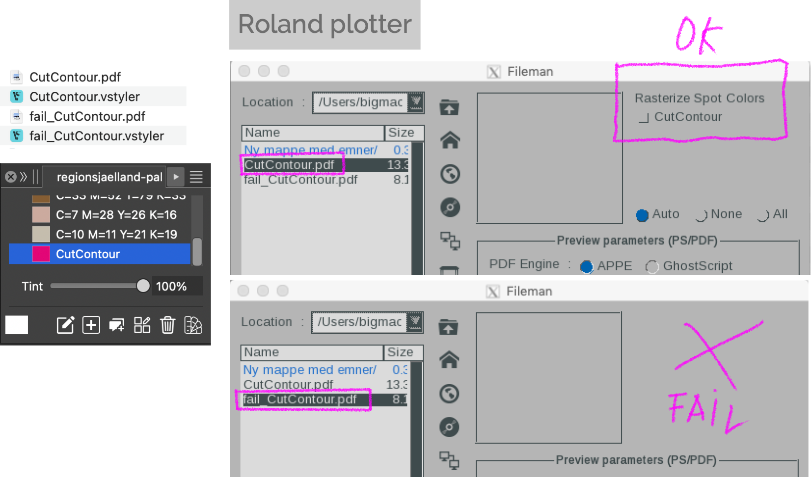

<p dir="auto">I have until now used VS outputting and sending files to a plotter without issues, but now I cannot output the pdf's correctly any more. The plotter doesn't recognize the CutContour spot color needed.</p>
<p dir="auto">I've attached 2x2 pdf's and VS files. The two of the latter works fine.</p>
<p dir="auto">To figure out the correct settings: Can you please tell the difference in the setup of the two VS's?</p>

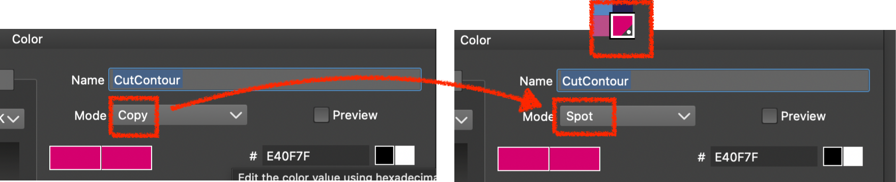

<p dir="auto">Great! I'm very thanksful<img src="https://www.vectorstyler.com/forum/assets/plugins/nodebb-plugin-emoji/emoji/android/1f60a.png?v=ec4d969cc53" class="not-responsive emoji emoji-android emoji--blush" style="height:23px;width:auto;vertical-align:middle" title="😊" alt="😊" /></p>
<p dir="auto"><img src="/forum/assets/uploads/files/1782128472255-6b0938e7-2f01-467e-a157-c1ecd13747cc-image.png" alt="6b0938e7-2f01-467e-a157-c1ecd13747cc-image.png" class=" img-fluid img-markdown" /></p>

You can see this in the Color Palette panel, where all colors are shown with a full box.</p>
]]></description><link>https://www.vectorstyler.com/forum/post/33538</link><guid isPermaLink="true">https://www.vectorstyler.com/forum/post/33538</guid><dc:creator><![CDATA[VectorStyler]]></dc:creator><pubDate>Mon, 22 Jun 2026 11:12:25 GMT</pubDate></item></channel></rss>
