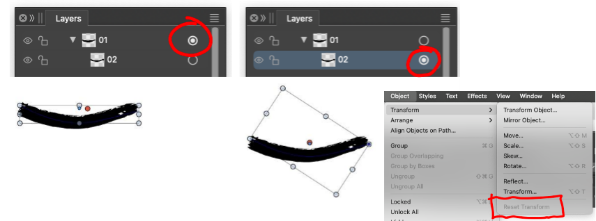

<?xml version="1.0" encoding="UTF-8"?><rss xmlns:dc="http://purl.org/dc/elements/1.1/" xmlns:content="http://purl.org/rss/1.0/modules/content/" xmlns:atom="http://www.w3.org/2005/Atom" version="2.0"><channel><title><![CDATA[How to Reset Transform or bake the bounding box?]]></title><description><![CDATA[<p dir="auto">This is something I need explained: Why can't I Reset Transform or bake the bounding box in subgroup 02?</p>
<p dir="auto"><img src="/forum/assets/uploads/files/1786023351726-86c0d912-b7e5-42a2-a6ae-172a3aebddc6-image.png" alt="86c0d912-b7e5-42a2-a6ae-172a3aebddc6-image.png" class=" img-fluid img-markdown" /> <a href="/forum/assets/uploads/files/1786023440604-issue-02.vstyler">issue-02.vstyler</a></p>
]]></description><link>https://www.vectorstyler.com/forum/topic/5893/how-to-reset-transform-or-bake-the-bounding-box</link><generator>RSS for Node</generator><lastBuildDate>Fri, 07 Aug 2026 01:14:08 GMT</lastBuildDate><atom:link href="https://www.vectorstyler.com/forum/topic/5893.rss" rel="self" type="application/rss+xml"/><pubDate>Thu, 06 Aug 2026 13:51:55 GMT</pubDate><ttl>60</ttl><item><title><![CDATA[Reply to How to Reset Transform or bake the bounding box? on Thu, 06 Aug 2026 14:14:25 GMT]]></title><description><![CDATA[<p dir="auto"><a class="plugin-mentions-user plugin-mentions-a" href="/forum/user/raaskot" aria-label="Profile: Raaskot">@<bdi>Raaskot</bdi></a> I tested the file: in this case "Reset Transform" is not applicable.<br />
Both layer transforms are already flattened, but this does not mean the object is converted to curves.<br />
When the child layer is selected, the parent layer transform will transform the bounding box.</p>
<p dir="auto">All these transforms can be seen in the Shape Effects panel.</p>
<p dir="auto">So in this case, only the Convert to Curves helps</p>
]]></description><link>https://www.vectorstyler.com/forum/post/33794</link><guid isPermaLink="true">https://www.vectorstyler.com/forum/post/33794</guid><dc:creator><![CDATA[VectorStyler]]></dc:creator><pubDate>Thu, 06 Aug 2026 14:14:25 GMT</pubDate></item><item><title><![CDATA[Reply to How to Reset Transform or bake the bounding box? on Thu, 06 Aug 2026 14:04:00 GMT]]></title><description><![CDATA[<p dir="auto"><a class="plugin-mentions-user plugin-mentions-a" href="/forum/user/raaskot" aria-label="Profile: Raaskot">@<bdi>Raaskot</bdi></a> This seems to be a bug.</p>
<p dir="auto">Use Object -&gt; Convert to Curves for flattening</p>
