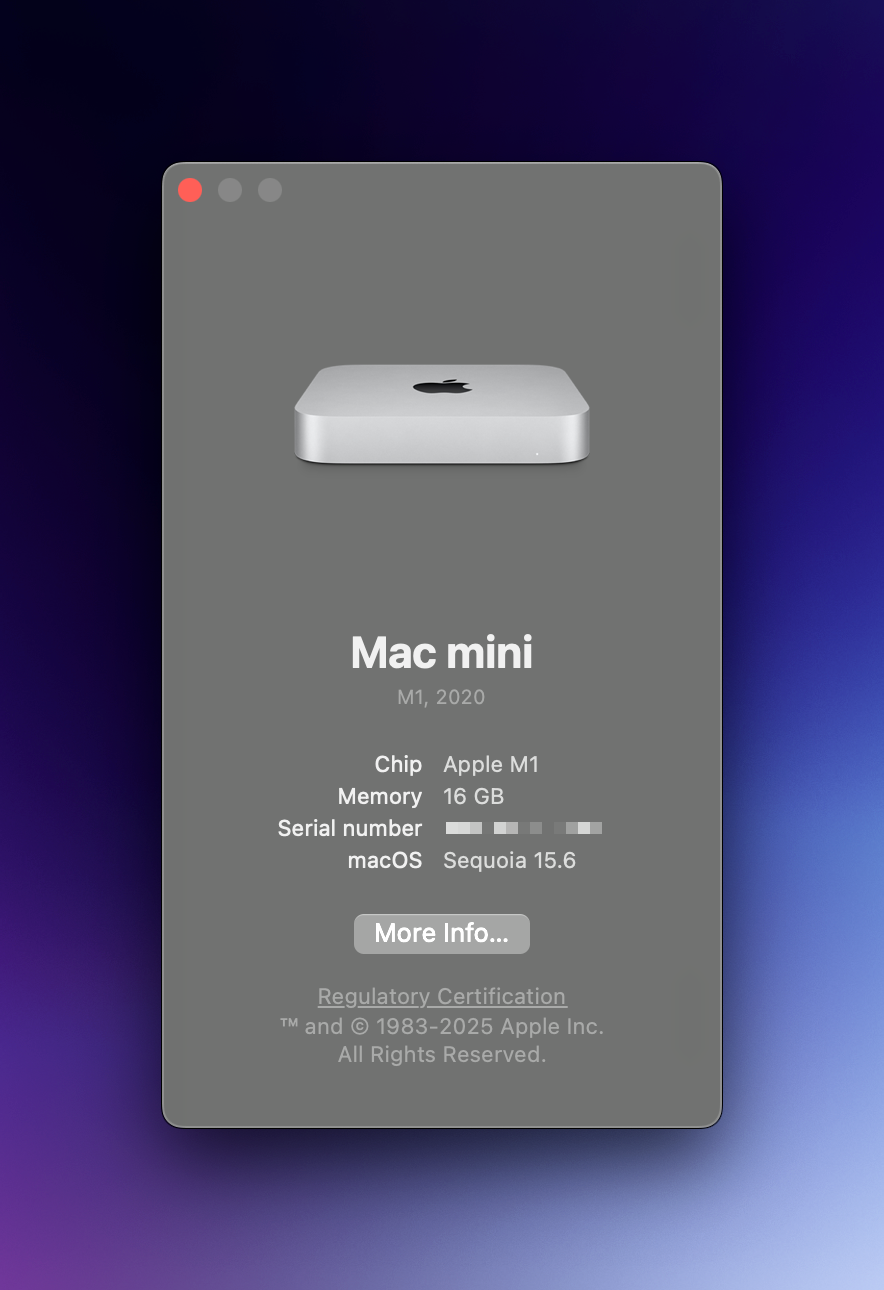

<p dir="auto">Im running O.S. Sequoia 15.6<img src="/forum/assets/uploads/files/1787356465845-cleanshot-2026-08-21-at-19.52.40@2x.png" alt="CleanShot 2026-08-21 at 19.52.40@2x.png" class=" img-fluid img-markdown" /></p>
