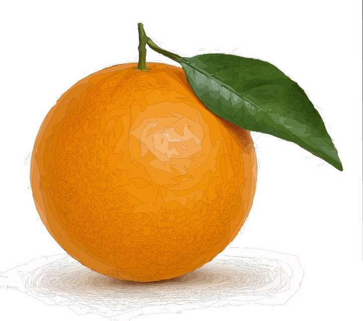

]]></description><link>https://www.vectorstyler.com/forum/topic/827/convert-photo-image-to-vector-white-edge-on-each-shape-of-the-vector</link><generator>RSS for Node</generator><lastBuildDate>Wed, 16 Sep 2026 07:05:45 GMT</lastBuildDate><atom:link href="https://www.vectorstyler.com/forum/topic/827.rss" rel="self" type="application/rss+xml"/><pubDate>Tue, 14 Sep 2021 14:34:28 GMT</pubDate><ttl>60</ttl><item><title><![CDATA[Reply to Convert Photo Image To Vector - White Edge On Each Shape Of The Vector on Sun, 19 Sep 2021 09:33:00 GMT]]></title><description><![CDATA[<p dir="auto"><a class="plugin-mentions-user plugin-mentions-a" href="/forum/user/kf" aria-label="Profile: KF">@<bdi>KF</bdi></a> Thanks for the image. I tested it, and with anti aliasing turned off (View -&gt; Subpixel -&gt; None) here is what I get:</p>
<p dir="auto"><img src="/forum/assets/uploads/files/1632043942031-trace2-resized.png" alt="0_1632043941762_trace2.png" class=" img-fluid img-markdown" /></p>
<p dir="auto">The anti-aliasing artifact is in the backlog (list of things to fix), and I will try to find a solution for that.</p>

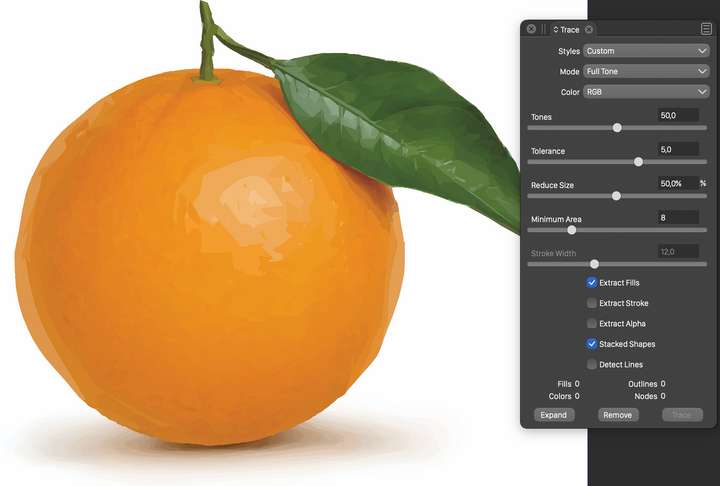

]]></description><link>https://www.vectorstyler.com/forum/post/4027</link><guid isPermaLink="true">https://www.vectorstyler.com/forum/post/4027</guid><dc:creator><![CDATA[VectorStyler]]></dc:creator><pubDate>Wed, 15 Sep 2021 06:36:35 GMT</pubDate></item><item><title><![CDATA[Reply to Convert Photo Image To Vector - White Edge On Each Shape Of The Vector on Wed, 15 Sep 2021 06:33:19 GMT]]></title><description><![CDATA[<p dir="auto"><a class="plugin-mentions-user plugin-mentions-a" href="/forum/user/kf" aria-label="Profile: KF">@<bdi>KF</bdi></a> This is a bit of a problem <img src="https://www.vectorstyler.com/forum/assets/plugins/nodebb-plugin-emoji/emoji/android/1f61e.png?v=06f033d742e" class="not-responsive emoji emoji-android emoji--disappointed" style="height:23px;width:auto;vertical-align:middle" title=":(" alt="😞" /> It is an anti aliasing artifact caused by exactly touching shapes. It has nothing to do with tracing, it is a rendering artifact.</p>
<p dir="auto">The only way to do away with this is to turn off anti-aliasing by selecting View -&gt; Subpixel -&gt; None.</p>
<p dir="auto">There is an open task in the backlog regarding this rendering artifact caused by anti-aliasing, I will try to find a solution.</p>
]]></description><link>https://www.vectorstyler.com/forum/post/4026</link><guid isPermaLink="true">https://www.vectorstyler.com/forum/post/4026</guid><dc:creator><![CDATA[VectorStyler]]></dc:creator><pubDate>Wed, 15 Sep 2021 06:33:19 GMT</pubDate></item><item><title><![CDATA[Reply to Convert Photo Image To Vector - White Edge On Each Shape Of The Vector on Wed, 15 Sep 2021 04:49:23 GMT]]></title><description><![CDATA[<p dir="auto">Hello,</p>
<p dir="auto">I am using Photographic for style and for mode is Full Tone. I have changed the tolerance to 5.0. If zoom in, the white edge of the shape ( especially the shapes within the leaf ) can be seen. Any ways to remove the white edge? Thanks. <img src="/forum/assets/uploads/files/1631680984953-orange-resized.png" alt="0_1631680983990_Orange.png" class=" img-fluid img-markdown" /></p>
