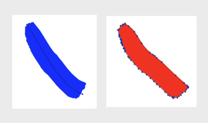

      How do you convert a stroke to a shape/curve? E.g. an artistic stroke.
      Here is a picture, I want the result on the right.
      I am on a PC, Win 10. Surely a simple thing, but I could not figure

        @Subpath2 A bit different for brush then stroke.
        For brush:
        • select the object with the brush.
        • select Style -> Expand Stroke (this results in an object with a bend effect).
        • select Object -> Convert to Curves (this results in a group of objects).
        • select Object -> Ungroup (or all) to access the content of the vector brush.
        Convert to Curve is not needed for stroke, but Ungroup may be needed if the object also had a fill (or multiple stroke).

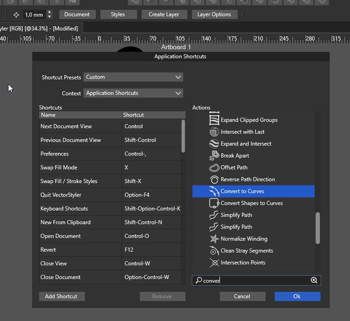

                                  View> Customize>Keyboard Shortcuts.
                                  It maybe useful for you. Sometimes when I'm not sure if something is possible Im typing in search field keyword .
                                  A few day ago I was wondering if I can select locked object, and the answer was there
                                  The entire customize menu is worth attention:)
