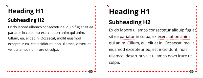

Auto-fit to container continuously scales the text to fill the available text area or shape: add text and it reduces in size; remove text and it grows. It preserves relative differences between mixed font sizes, so fixed point sizes cannot be maintained.
On the left you have a text box with empty space at the bottom. When I click auto-fit, the empty space is used up. If I enlarge the box, the text scales with their relative differences preserved. Very useful when you want to reuse text elements for multiple artboard sizes.
Shrink text on overflow only reduces text size when the text would overflow; it does not enlarge the text again merely because extra space is available.

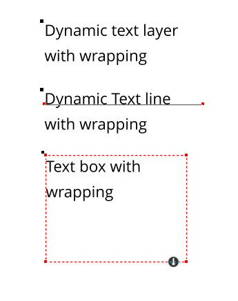

Dynamic text layer, text line, text box and text columns: Dynamic text layer already in VS. You click and start typing. The text goes on forever. But you can't wrap line. You should be able to. Text line - Already exists, but is miscategorised. Text on Path Tool. Why? Because it is a sub class of Dynamic Text layer. Instead of clicking and typing, you draw a line and type. No need for a separate tool. And yes, you should be able to wrap line here too.
Three class of text objects. One tool. Click, drag a line, and drag a marquee. And if I drag down hand of the line, it should immediately become a text box.

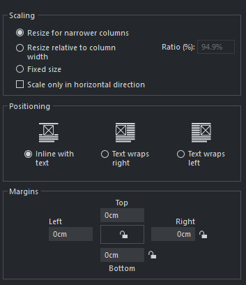

Likewise, a simple toggle should change the dynamic text layer to a line or a box.- Embedding Graphics: Embedding graphics within text boxes should be a simple matter of either dragging a shape or image into the text frame in layer panel or pasting the object into the text box from the clipboard. Then there are the embedded graphics options.
Wrapping probably already exists. I haven't found it though. But I should be able to set this quickly. Notice the top portion of this dialogue box. It's the most useful and interesting one. If I convert the text box to columns, the embedded graphics shrinks and fits the column per my setting. Superb! There's also the option to scale only the horizontal direction for instances where you have embedded say a button with text on it. You need the vertical size fixed. Again, extremely intuitive.
