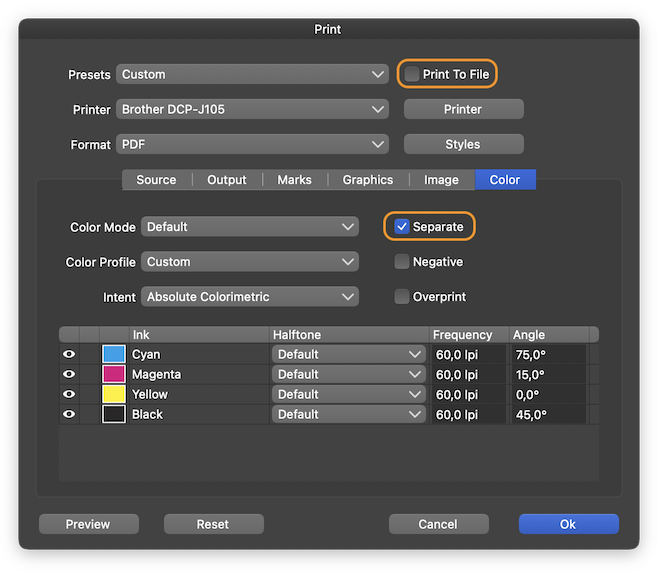

            @Boldline If the document is in CMYK color mode, you should have a 'Separate' checkbox here in the Print dialog. Check that one, also check 'Print to File', then clicking the 'Print' button should generate four PDFs with each separation for Cyan, Magenta, Yellow, Black and maybe Pantones if you have those in the artwork.

                @Boldline Everything in each of the generated PDFs is in black, but it will be in different percents — if for instance the artwork includes an orange object (C0 M50 Y100 K0), the PDF for the Magenta separation will have that object displayed in 50% black because on the Magenta plate that object needs 50% magenta.
