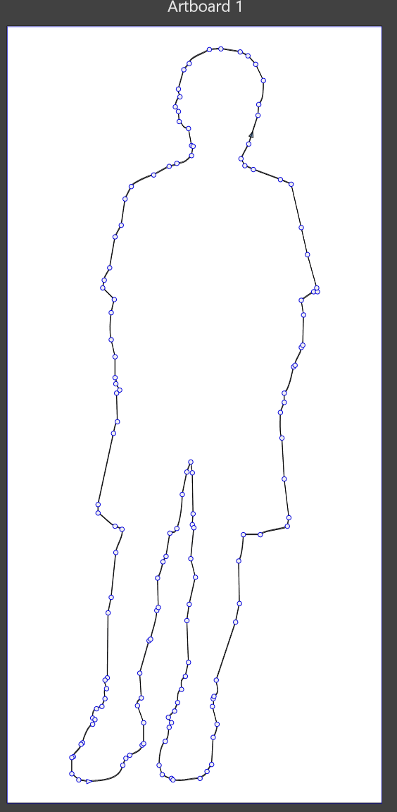

After tracing / expanding / ungrouping
selecting and delating.. i have go to this,.
I still can't seem to select the outline and select 'fill' or adjust the stroke or anything though ?
I just want to get it to a usable path !?

@ambros Because the image has a thin white contour, tracing it with the default settings will result it two objects — a black shape and a separate gray contour.
So I guess you deleted the black shape and then tried to change the fill of the gray contour instead of deleting the contour shape and using the black filled shape.
@ambros Essentially @b77 explained all:

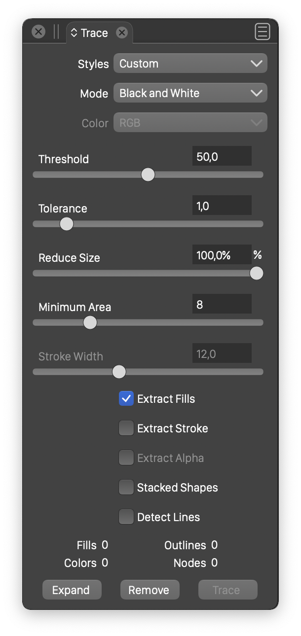

It has to be expanded and ungrouped to have the vectors.Here is what I get with tracing:
0_1637848320190_imagetrace1.vstylerThese are the settings I used:
Also: the forum file size issues are still persisting.

@ambros One option that might also be useful:
If you do not need the "live" feature of the trace, then uncheck the "Keep with Image" in the Trace panel menu.
In this case, there will be no need for expand, but an ungroup is still needed to get to the resulting curves. -
