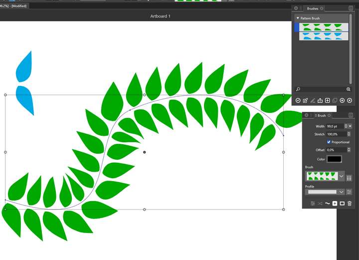

It this pattern along trick possible and easy in VS?
@Ingolf This can be done with Pattern Brush.
https://www.vectorstyler.com/documentation/brushes/pattern/Create a new pattern brush from those leafs.
Draw a path and apply the pattern brush. -
This is what happens (this is from Windows) - I'll share the VS file later today if needed
@Ingolf Send me the file.
But from the recording, all seem ok. It just that the brush width must to be adjusted. -
@Ingolf Also: in the Brush Style panel, there is a Proportional button for this.
@vectoradmin
Thanks, adjusting the stroke to 100 points helped. I also found the proportional button now.
I was looking in the "Brushes" panel that I found was in fact the "Brush styles" panel. You might consider renaming the styles panels to reflect it is a list of styles. In this case I was looking at a "Brush" panel and "Brushes"

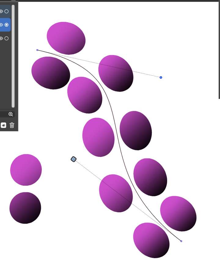

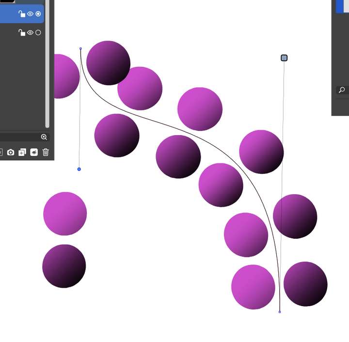

@vectoradmin I don't think the Rigid Shapes setting is working in this file? If you move the start-and-end handles to almost vertical or horisontal positions it does work - but not in between.
@Ingolf Yes, this can be replicated, there is some issue with the Rigid Shapes option here.
