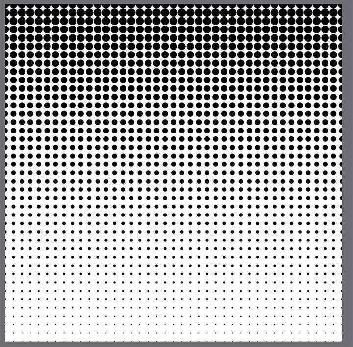

 This would be a straight grid:

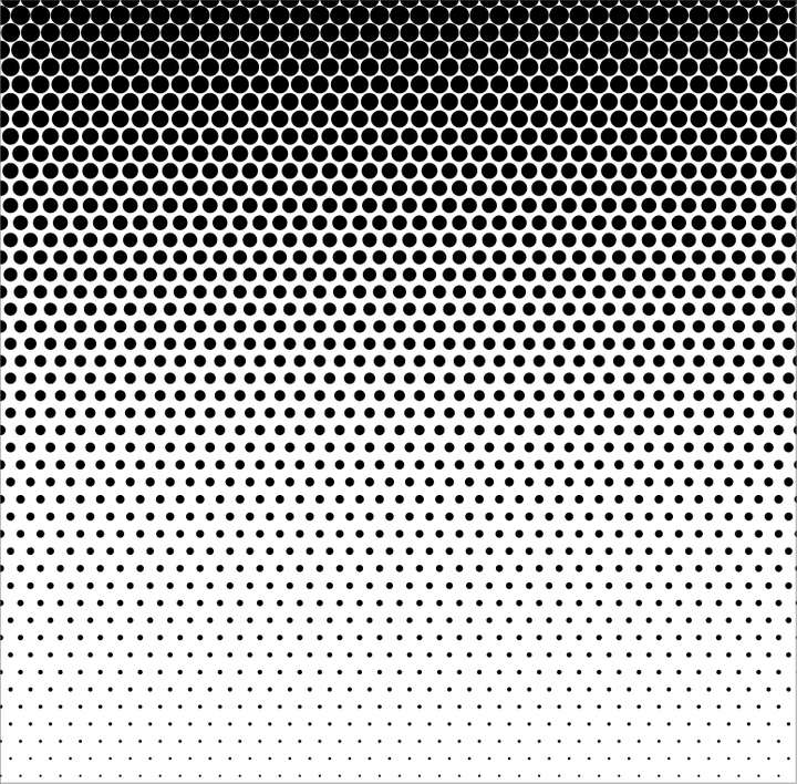

  This would be an alternating grid:
 @Boldline said in Repeaters additional options: This would be an alternating grid: That can be achieved by setting the first Shift value to 50% and setting a negative spacing.
