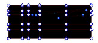

      freggern
      When you add a shape to a document and go to the mesh gradient editor and click on the shape it fill the shape with a black background.
      Problems:
      • The black background should be I think transparent
      • In the exported svg the shape is now transparent (you can't see it but its there) and not with a black background
      • you can't see the mesh line, because they are black (should be the same color as the border of the other elements (points, triangles)?).

        • F Offline
          freggern
          Make some investigation. The problem is when there is a "alpha channel". When I start with a ractangle not filled (so transparent and with an alpha channel) and select the ractangle with the Mesh gradient editor the alpha channel looks like is not supported and rendered as black color in VS?

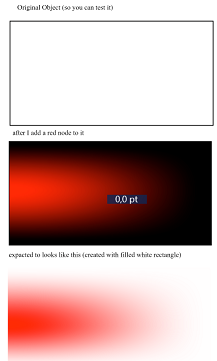

          • F Offline
            freggern
            Also with no filling the mash gradient editor doesn't detect when I click inside the element to create a new node (only on the border see above animation). With filling it create a node (second click on black).
            Edit: To make it clear
            alt text
              VectorStyler @freggern
              @freggern Selection with the no fill problem can be replicated. This looks like a bug
                @freggern Alpha channels are supported in VS (assign opacity for a mesh node).
                I need some help replicating this issue. Can you send me (email csraba at vectorstyler.com or upload here) a file where this alpha channel is not rendered? Thanks!
                Maybe it is some other issue.
