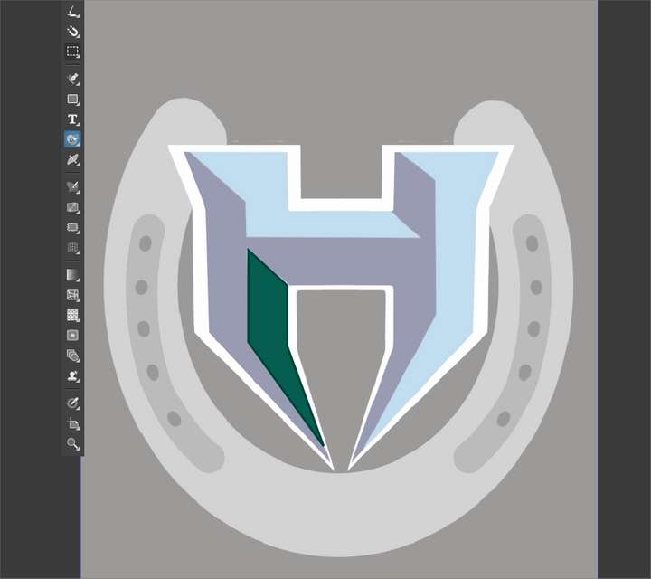

      Trying out the Shape Paint tool more, it seems like it could successfully replace what "live paint" does in Illustrator.
      However when using it in this situation, it was not recognizing the pink strokes I had selected along with the outer green stroke. My expectation was that it would recognize any and all strokes within the selection and each closed space would get highlighted for potentially a different color fill.
      0_1641918606890_2a8914c6-400b-4514-bba1-1272c71fa025-BLD 2022-01-11 at 11.29.58.png

          Trying a fresh shape paint selection, this time I am able to pick up one part of the pink stroke, but not the others, and I can't fill the interior of the pink stroke section.
          File is attached:
          0_1641919454044_Horseshoe.vstyler

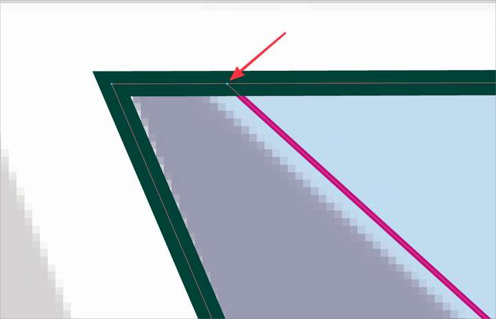

            @Boldline The problem is that the thin pink lines should intersect with the green line (not just the stroke, but the actual curve).
            Moving just a bit the endings of the pink lines can fix the issues.

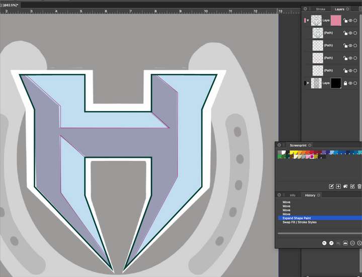

              I understand I can drag with the shape paint tool to merge sections together - but when I did it in this same example, I was able to only get one portion to fill
              0_1641919883293_3213f1c3-ae45-4455-9436-72ce8957adc2-BLD 2022-01-11 at 11.50.01.png /Users/bldneo/Library/Application Support/CleanShot/media/media_c3s3tTCrKw/BLD 2022-01-11 at 11.50.01.png
                @vectoradmin said in Shape Paint not recognizing inner divisions within overall shape:
                Can you clarify more what you mean about the "actual curve"? I am only using strokes in this example and I used the snapping guides when I created it to get the pink stroke to touch the green stroke. The rest of the pink stroke sits underneath the green stroke
                The stroke needs to extend beyond where the snapping puts it?
                0_1641920076061_4a3538b8-dea9-4f63-a558-57bc5b69bebe-BLD 2022-01-11 at 11.52.33.png
                  @Boldline It looks like those top green lines are not exactly straight, so Snap to Object will not position the ending node precisely.
                  Use Snap to Shape (and disable Snap to Object) for this

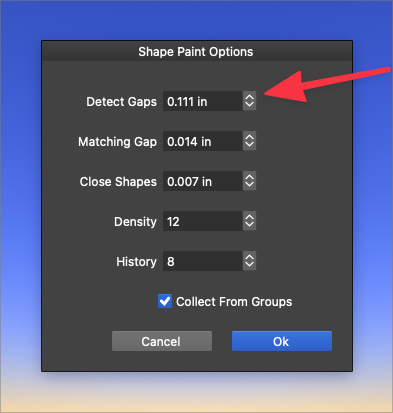

                    @vectoradmin thanks - Could this also be remedied by increasing the "detect gaps" setting? While I understand why it is happening, trying to think ahead for future use - the less fiddling with exact placement the better. could this be adjusted some by default to compensate for these small discrepancies?
                    0_1641921413951_9478340c-72dc-4523-8502-25c7caee1cdb-BLD 2022-01-11 at 12.14.14.png
                      @Boldline That should work, but it seems that in this case the gap is only applied between endings of open shapes.
                      I opened a bug on this one.
