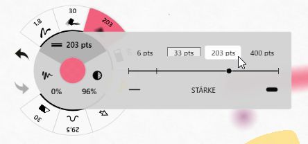

          Found a Solution in the App "Concepts" which i found nice.
          I don't know if it would fit in the conecpt of Vs,
          You can define 4 values yourself, if you click on
          the respective value the slider jumps to this value.
          (with a doubleclick onto the Value Button/Field
          you can edit the Value)
          Here a Picture:

                i agree that the "Concepts" slider is made for tablets. But they are
                also available in the Windows version of Concepts and they work
                wonderfully also with the mouse. But apart from that, i also think
                that a slider like in Concepts would be a bit too much for VS.

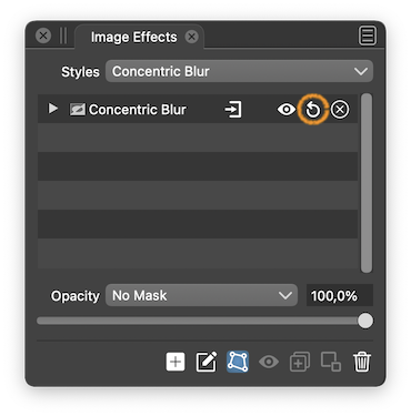

                    Btw, possibly useful:
                    Each effect can be reset to its default values with a click on this counterclockwise button:
