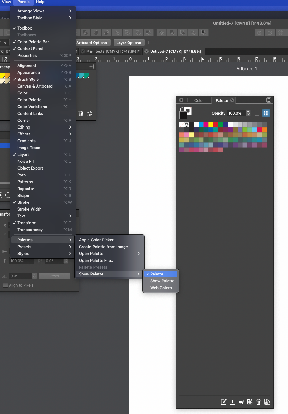

      If I want to build a custom color palette in VS for spot color printing, what would the steps be to do so? What type of palette would I need to start with?
      Can I have two different palettes open and pull colors from both palettes to make a design and then when I export, will it save spot colors from both palettes, or do they need to be in the default palette? If the latter is true, then if I open other spot color palettes, I need to be sure I move a copy of the swatch over to the default VS document one?
      When I open a new document, I can go to panels>palettes>show palette>palette and see what I believe is the default palette VS opens with.

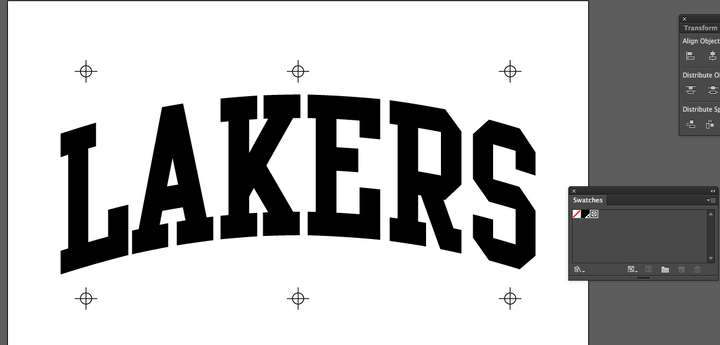

        I was able to somehow get my custom spot color into the default palette and I set the wording to that spot color and then made the reg marks "reg color"
        0_1642627906861_Print test2.vstyler
        0_1642627956901_4ecc517a-3805-48e7-bb61-268e66550714-BLD 2022-01-19 at 16.32.24.png

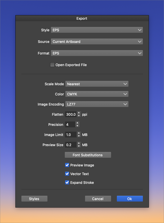

        I tried exporting it as an eps file with these settings:
        0_1642627993565_d2ef48cf-5488-45fe-8e51-f62595304177-BLD 2022-01-19 at 16.33.01.png
        It exported an RGB file instead even though I told it to produce a CMYK version. Also, the registration marks are missing
        Here is that eps file: 0_1642628096704_Print test2.eps

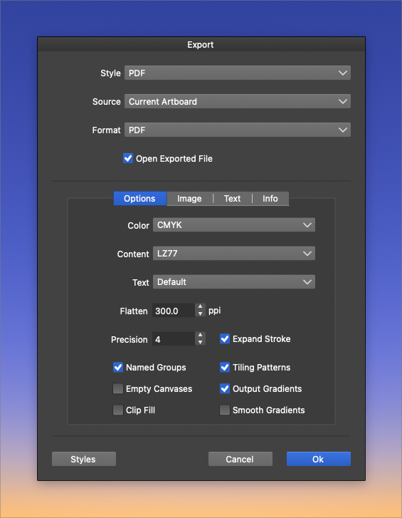

        I then tried to export the original VS file again, this time as a PDF file
        Here were the settings for that attempt:
        0_1642628224384_671f8a87-d7f3-4819-bd26-94d5ca06da86-BLD 2022-01-19 at 16.35.57.png
        Saving out as a pdf gave me a strange file name as it included "eps" in the name, even though I only specified I wanted it to be a pdf. The registration marks did show up this time, but the file is also an RGB file despite my selecting CMYK output in the export panel
        Here is that pdf file: 0_1642628566988_Print test2.eps.pdf

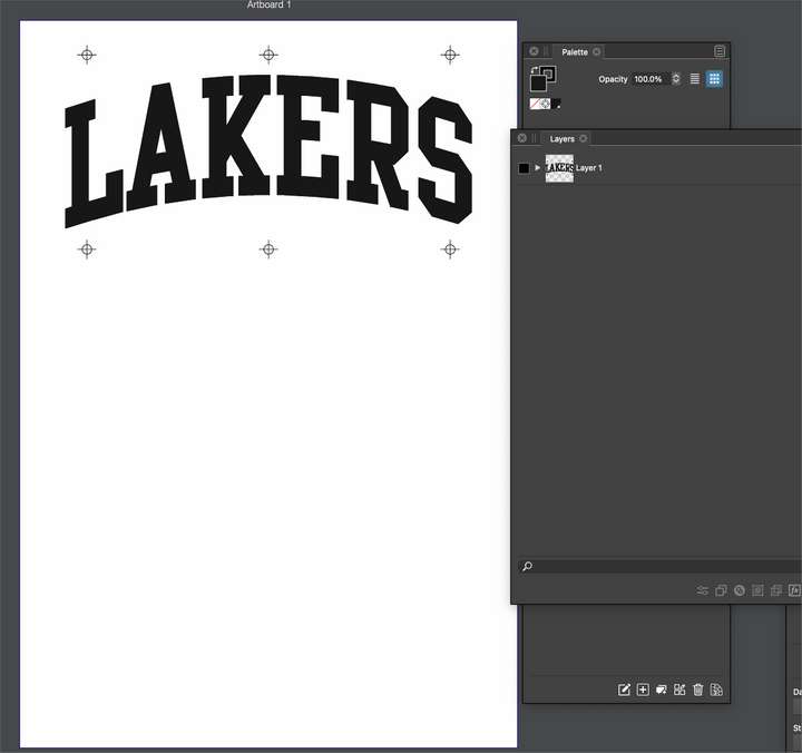

            @b77 When I open the exported eps or pdf file in VS this is what it says in the tab
            0_1642629927225_c3a43fab-c335-4210-92c6-02a6def59ba5-BLD 2022-01-19 at 17.04.51.png
            When I open either file in VS again, it does not retain the reg mark color nor the opaque black spot color. and one one, it opened without the reg marks showing at all... I had not tried them in Illustrator. I will do that now

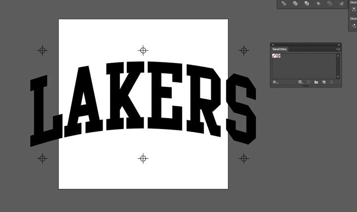

                  @b77 well, the good news in all this - when I opened the pdf file in Illustrator, it retained the reg mark color as well as my spot color black!!!!! It did require I expand a clipping mask applied to the whole file. This must be added when the pdf is made. Is there a way to avoid this?
                  When I opened the eps file - it retained only the registration color, but not my spot color and @vectoradmin it still is defaulting to what illustrator sets as the artboard like we discussed before. Probably no real way to fix that right?

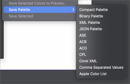

                          @Boldline About custom palettes: these should be saved to some user folder, and then in Preferences -> Folders select the "Color Palette Folders" in the Folder Mode field, and add that user folder.
                          Now any palette saved to that folder will show up in the palette menus.
                          For a VS palette type use the Binary or Compact formats. For human readable VS palette use the XML or JSON formats.
                          The other formats can also be used, if you want to use the palette in those apps.
                          In VS spot colors are only allowed in the primary color palette (the one stored in the document). The "Register.." options are used to register a color from the external palette into the primary, when it is applied.
                          I add to the backlog a task to have spot colors in external palettes, but these of course then will auto-register into the primary when applied.

                              @vectoradmin said in Building a custom color palette in VS for spot color printing:
                              I'm new to all of these considerations. I assume you are referring to the overall file type?
                              In documentation, the available storage modes are briefly discussed; "This can be Compact, Binary, JSON or XML. The Compact storage mode offers the most compact file in terms of size and speed of saving and opening. The Binary storage mode is next in terms of speed and size, but allows a more future proof format. The XML and JSON storage modes allow access to the internal VectorStyler object hierarchy for 3rd parties and external scripts for processing."
                              Could this be expanded upon in the documentation at some point? Is there a reliable source online I could go research? I did some googling but did not find or understand what I was reading. This was not something I was introduced to when I was using Illustrator for example.
