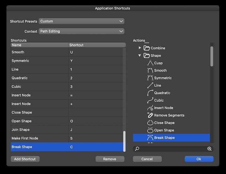

        Here's what I did:
        • I chose 'Keyboard shortcuts…' from under the VectorStyler menu;
        • selected 'Path Editing' from the Context menu;
        • expanded the Object menu, then the Shapes submenu in the column on the right;
        • there I selected 'Break Shape';
        • clicked the 'Add Shortcut' button;
        • selected the new entry (Break Shape) in the left column;
        • pressed C on the keyboard to add 'C' as a shortcut.

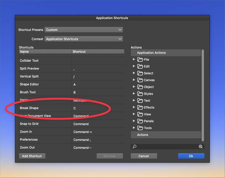

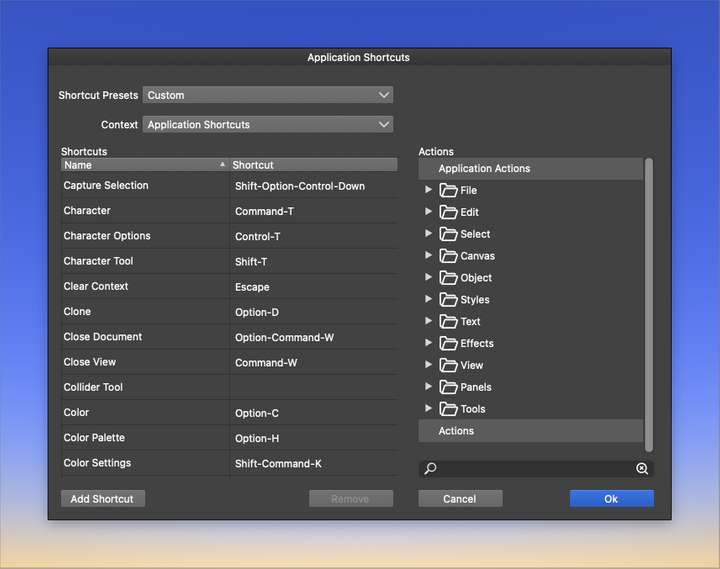

          @b77 I appreciate you breaking it down for me. I can see now that I stole the "C" option from the collider tool as it's no longer listed there:
          0_1642707883202_1b5556e2-9830-4cea-8174-b68ecb04e4b8-BLD 2022-01-20 at 14.43.57.png
          It appears I added it to break shape correctly - but I will try and use it again with video
          0_1642707981521_3c8eb5c4-bf34-4cb2-8bae-513ec1fb4ff0-BLD 2022-01-20 at 14.45.36.png
          I'm clicking on the node to highlight it and then pressing "C" as I have it custom set for the "break path", but nothing seems to be happening.

            @Boldline 'C' for the Collider tool is gone probably because you didn't change the Context from 'Application Shortcuts' to 'Path Editing'.
            1. Add 'C' back to the Collider tool with Context set to 'Application Shortcuts', then…
            2. Change Context to 'Path Editing' and add 'C' to 'Break Shape'.
              Boldline @b77
              @b77 Thanks for showing me that discrepancy in my choosing where and what to add! I didn't catch it until the second time you asked about it! yikes.
              the amount of customization is crazy and I had not thought about it being in another category like that, but it makes total sense. Im not going to use "C" now that I know collider uses it so I'm thinking of another
