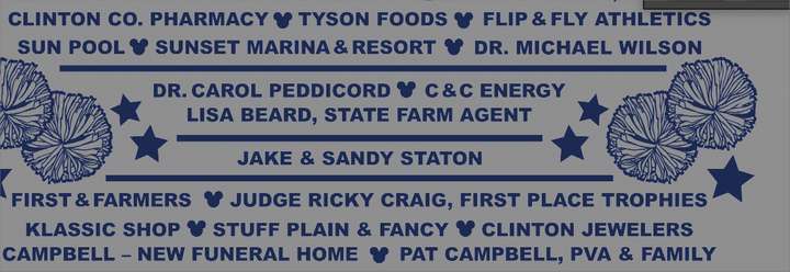

      This is probably already in VS, but I am looking to be able to set the gap space between independent lines of live text. If I have several sets of rows of text for example, setting them to a certain gap in between. Usually I just have one long list of names for example, but other times I have segmented lists divided into groups.
      I know I could gather all the names in a single list and set the gap for all at one time and then moved around as needed, but I'm sure there's a better way

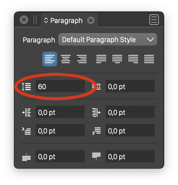

        @Boldline If that is a multiple line text (in a single point or frame text), then in the Paragraph panel, the Leading can be set to less than 100%
          @vectoradmin That makes sense. But in this specific case, I'm dealing with multiple single lines of text with vector shapes interspersed - so that would not work here.

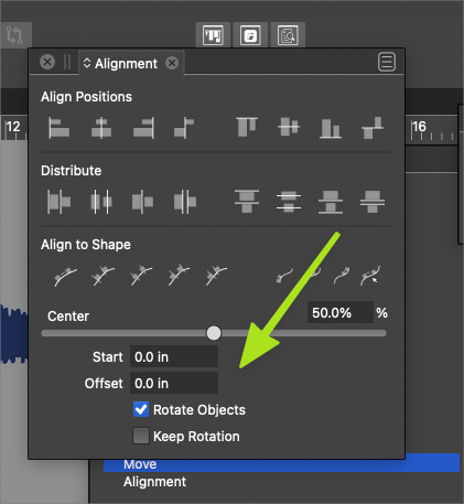

              Giving it more thought , I'm thinking of it backward. what I may be actually requesting, is a way to specifically set the spacing between vector objects/text lines.
              I have not spent enough time to fully understand all the options in the alignment panel yet, but for the distribute section - an option could be added to set a specific amount of distribution between selected objects. A numerical input box where I could set the exact amount of distributed space.
              0_1643640349178_3a03e090-07f3-4b8c-8aec-ae58043a35e2-BLD 2022-01-31 at 09.45.33.png
              VectorStylerV BoldlineB 2 Replies Last reply Reply Quote 0
                @Boldline There is such an option https://recordit.co/WfG9RWpXrl 🙂
                S BoldlineB 2 Replies Last reply Reply Quote 4

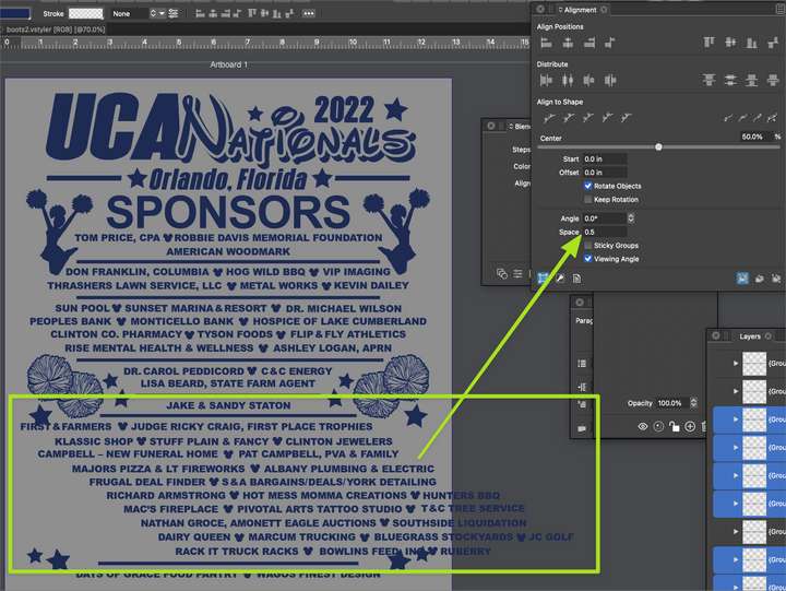

                      is there a setting I am missing? When I select several lines to space with this method, it works, but the centered column of text spreads out and I have to reset it back to centered
                      0_1643645396954_ddc90d27-10e7-4f67-bc52-4f3bc9754567-BLD 2022-01-31 at 11.07.58.png
                        @Boldline After you enter the number in the Space field, do not press Enter. Just click on the top-right alignment icon.
                        Confirming the Space with enter will apply the last alignment mode, or the default (left) alignment.
