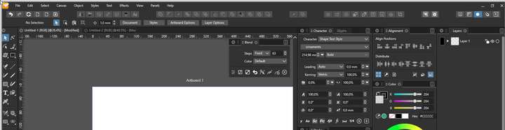

            • J Offline
              Jayanta Das @encart
              @encart Same here. appeared I dont know after pressing some keys on the keyboard.
