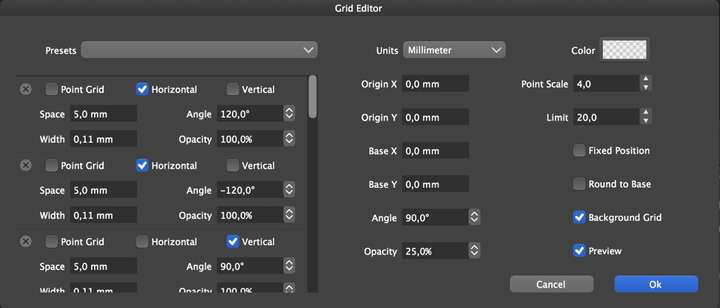

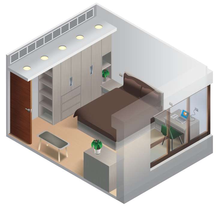

      Hello Everyone,
      I'm a new VectorStyler user after many (!) years of working with Adobe Illustrator then Affinity Designer (like some people here). I'm trying to get used to the software so I decided to skip the creative part and to focus on the tools. That's why I did this isometric drawing.
      For those who are interested in making isometric illustrations in VS, I put the grid settings I used below.
      alt text
      alt text
      alt text
      alt text

        @Devil-Dinosaur I appreciate your generosity in sharing - but I don't see where you shared the info
        • Devil DinosaurD Offline
          Devil Dinosaur
          I guess you mean you don't see the images ? (iso drawing and settings). It seems that only Firefox and Safari can display it. I put the settings print screen and one image on this cloud then. 😉

                    @Devil-Dinosaur
                    Did you also use transformation cages e.g. for the round lights ?
                    Or did you do everything just with the help of the grid ?
                    Devil DinosaurD 1 Reply Last reply Reply Quote 0
                      Devil Dinosaur @Subpath

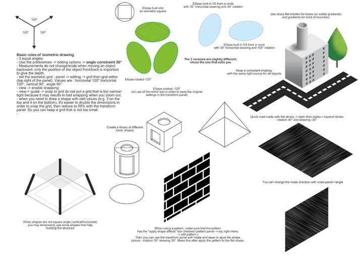

                      @Subpath Ellipses are made according to the square, like in 2D. In 2D you can fit a square both outside and inside a circle, I use that as a reference and my ellipses fit an isometric square. I also set the rotation constraints to 30° angles. Using 30°, 60°, sometimes 120° is very useful. In some cases, I first rotate 30° then skew accordingly. The AC holes were done easily that way : dash lines, rotated 30°, turned into curves (style->expand), then skewed 30°. The good thing in isometric is that scale doesn't change when objects move backward, so you don't have to change the space between repeating object for instance.

                          I put a link below for those who want to download some info and tricks about the isometric drawing. Since it's a VS file, feel free to add your own tips and correct my "globish" if necessary 😁
                          Iso mini tuto
                          or
                          Iso mini tuto (link 2)
                          My website is not https, so your browser may refuse to download thru the 1st link.
                          Fred.

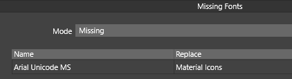

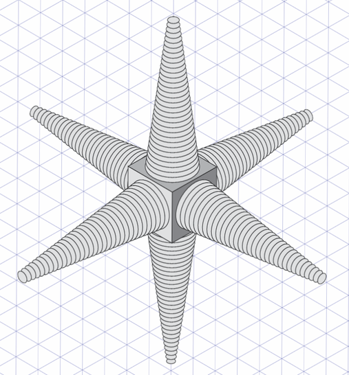

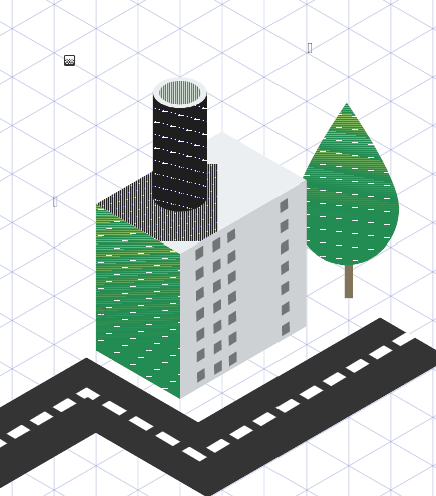

                            There are unfortunately a few small problems when I use the file into VS.
                            Works so far, but one font is missed / can't be displayed and the examples
                            with the noise effect may are not displayed correctly I think.
                            Here some Pictures
                              Devil Dinosaur
                              Sorry for the font, I used Arial unicode and Arial rounded.
                              I'm quite surprised about the gradient (less about the noise). It's strange that a native VS file cannot be read easily on another computer. That's why I skipped the PDF. I will check my preferences... (edit: if it make a difference, my file is CMYK)
                              Same document with embedded color profile
                              Here's how it should look :
                              Fred.

                                No problem, I also wonder about the font, I have Arial (actually a standard
                                font on Windows) installed, but not the Unicode version, which seems to be a
                                little different. I think it also contains special characters for other languages.
                                I also wonders about the Effects.
                                Thanks for the bitmap version which works fine, naturally 🙂

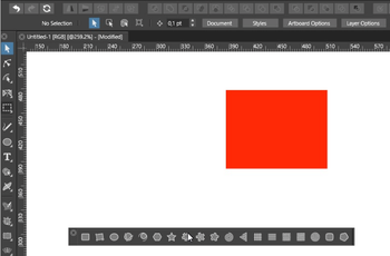

                                  @Devil-Dinosaur
                                  Want to show a little trick I once figured out in Affinity Designer
                                  (which has the great Isometric Studio) while playing with Symbols
                                  in Isometric Studio.
                                  Something similar also works in VS. Might be useful for complicated
                                  Isometric shapes in VS. I use Clones in VS for that.
                                  Here is the video:
                                  Isometric Clone trick
                                  Devil DinosaurD 1 Reply Last reply Reply Quote 4
