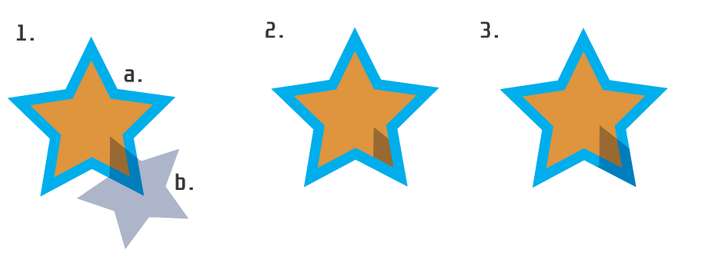

      Hello,
      Noob question, please refer to the below image.
      I would like to clip shape b. (50% transparent with blend mode set to Multiply) with shape a. so that the result takes into account the stroke of a. The result would look like 3.
      Result 2 is possible with placing b. inside a., but it does not encompass the stroke.
      What would be the most efficient way to do this?
      Thanks for your help.

        VectorStyler @Victor Vector
        @Victor-Vector Make the star a bit larger, place (b) inside (a) and align the stroke inside in the Stroke panel.

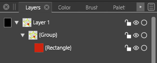

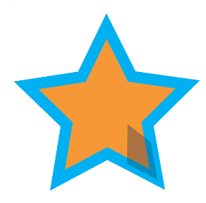

          • create a star
          • create a rectangle
          • select the rectangle and cut it in the clipboard with Ctrl+x
          • double click on the star (to put it in isolated mode)
          • now paste your rectangle
          • place it over the star as desired
          • double click on the Canvas (to come back from isolated Mode)
          • select the star and give it an outline
          And here is my Result
          you could also drop your rectangle
          in the layer panel into your Star
          this gives me the same Result

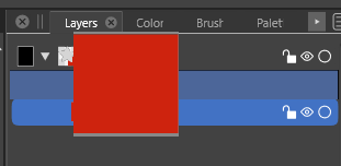

            @Victor-Vector You may want to rearrange (with drag&drop) the Fill / Stroke / Group items in the Appearance panel, to have the "Group" on the top.
              Subpath @VectorStyler
              @vectoradmin
              interesting did not know that

                Thank you for helping with this. Your first solution (stroke aligned to the inside of a slightly larger star) works very well and is probably the best way to do this. It seems obvious to me now, haha.
                I was excited about your second solution (rearranging the fill / stroke / group items in the appearance panel) because I did not even know that was possible. It has some very interesting results when the stroke is centered along the path. Cool!
