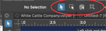

    0_1647710423716_eb5bb9bf-8e5d-4766-8b99-fffe4d447612-BLD 2022-03-19 at 13.19.56.png
    @Boldline I added this to the backlog, but this would not be suitable next to those selection modes.
    Those are "what we want to select" mode options.
    And this would be a tool for "what we want to do".
    So the "Move tool" would work better among these (next to scale, skew, rotate tools):

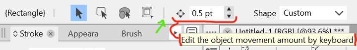

    I wanted to add to this thread to call out what I thought was a brilliant function of VectorStyler in the Context Panel:
    This (in red) has greatly helped me with the issue @Boldline is describing, as I can fine-tune my arrow keys to get around this.
    That said, I also agree that an object "Move Only" mode is a good idea and not something many vector graphics apps have. 👍 nice idea!
    As for placement of the "Move Only" Tool, may I suggest an additional location?
    Considering how it is so close in function to the "Edit the object movement amount by keyboard" (image above) perhaps it can also nestle between this and "what we want to select" mode options? See green arrow in image above. This would put it close to where @Boldline originally thought.
    But yes, it still should also be placed on the tool bar where @vectoradmin suggested, in the "what we want to do" area...

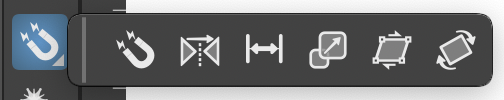

  • I was prompted by this conversation thread to go spend more time with the "what we want to do" section of the vertical toolbar - to get a sense of what adding the move tool would be like there. I must admit I have never really done much with these tools until now because most of them can be easily accessed by way of the standard transform tool. It made sense to me to have multiple methods to access tools but my preference had always been to just use the shortcuts tied to the transform tool.
    What stood out to me this time, was noticing that each tool did only what it was advertised to do - and nothing more. If I was scaling, that was literally the only thing I can do with that tool - I could not even move the location on the artboard of the selected item I was scaling!
    This gave the tools listed there a new value in their simplicity - if I only wanted to focus solely on scaling or flipping it or skewing or rotating, I could do that without worrying I was accidentally tweaking it in another way. These tools offer singular focus already - which is what we also want with a move tool - it fits right in with everything in that section already. The standard transform tool gives us all of that at once while this section gives us that singular focus - the thing missing until now was a "move" singular option.

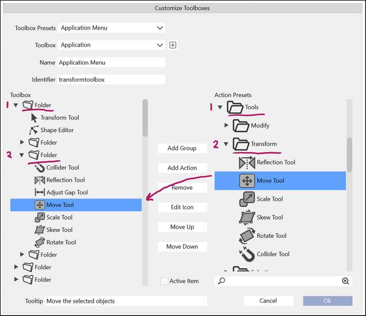

    @Boldline There is a "Move" tool next to the separate Scale, Skew and Rotate tools, in build 1.1.024
  • For those not using the Default Toolbox, you may add the new Move Tool here, under View > Customize > Customize Toolboxes:
