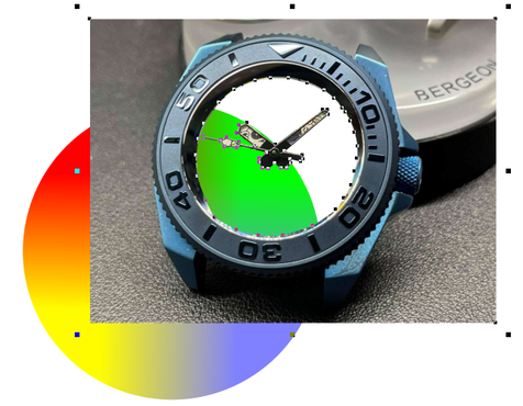

                      @Subpath I tried the example of the Boolean Intersect. With an image on the bottom and a solid rectangle on top, I hit the boolean intersect button and I don't get your result. My result is in the GIF below. Not sure why. I am running on Win11, VS 1.1.028 just started up, with a newly opened file.
                      alt text
                      I would argue that @vectoradmin's method of the "Transform tool, 4th tool in the Context Panel" is much simpler and easier for a basic rectangle crop even if it doesn't use a frame adjustment method to do the crop.
                      @Boldline The clip method (as seen in my first post) is possible to work with all shapes, but the prepackaged shapes (rectangle, ellipse, start, etc.) have to first be converted to curves before they can nested/clipped together or else you just get the shape editor control handles when you attempt to use the Shape editor tool (node editor).
                      So the best solution for rectangular cropping is: to use the "Transform Tool, 4th tool in the Context Panel" as it is, with the future option of updating the user interface to crop with frame handles, if there is a demand.
                      The best solution for a shape other than a rectangle is: to use the clipping method, but just make sure your shapes are converted to curves before nesting/clipping. Boolean Intersect is good if it works like @Subpath's does, but it's not working for me.

                                  Subpath @Victor Vector
                                  @Victor-Vector ....I tried the example of the Boolean Intersect....
                                  Here's how the Boolean method works:
                                  The Order of Selection matters.
                                  so selection Rectangle want work
                                  1. Place your shape on your bitmap.
                                  2. Hold down the Shift key and select the shape.
                                  3. keep holding the Shift key and now select the bitmap
                                  4. now select Boolean "Intersect" and you have
                                    the result like in the gif-anim
                                  Importand Note: With the Boolean Methode your
                                  Bitmap will be Cropped ( not need to Rasterize it later on)
                                  But also you couldnt extent the Cropped Area later on!
                                  Like in the Clipping Methode.

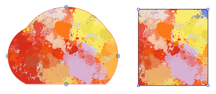

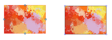

                                  Here's how the Clipping Method works
                                  The Shape doesnt need to be in Curves at first.
                                  You need his only if you like to extend the clipped Area.
                                  Experiment a bit to get the feel of it
                                  Cropping ala Ingolf is just the same as Clipping,
                                  is just a other way to clip.
                                  some pictures
                                  shape in curves is on the right
                                    b77
