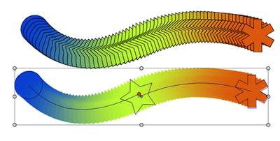

                        VectorStyler @Nils
                        @Nils said in How to get the interpolated states of blends between shape variations to generate correctly:
                        @vectoradmin Since I got your attention here: I've noticed that it's quite difficult to get the interpolated states of blends between shape variations to generate correctly. Do you have any general advice ( doesn't have to be detailed ) on how to approach this to get more consistency.
                        In some cases the Blend mapping tool might help: https://recordit.co/Sc4zRr81u1
                        Use double clicks to add mapping points at locations along the shapes, and then drag these to the proper place on each shape.
