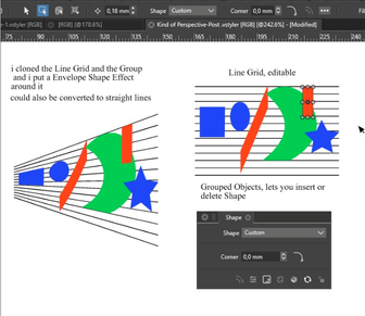

          Subpath
          Here one of my tries.
          Kind of Perspective in VectorStyler
          Only the perspective is not really right
          would have to be adjusted.
          Video: Kind of Perspective in VectorStyler

              Subpath @VectorStyler
              @vectoradmin said in Perspective ideas from Corel for a future VS update:
              @Subpath 4-point distortion can be used to simulate perspective, but it may bend lines a bit.
              I know that the 4-point distortion can do that.
              But I found that I have more options,
              if I use the envelope shape and
              the envelope can also be easily converted to
              straight lines.

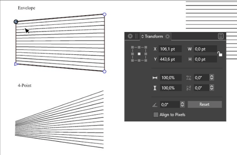

                Subpath
                @vectoradmin
                Here why i choose the Envelope Shape
                Video: Why Envelope for Perspective
