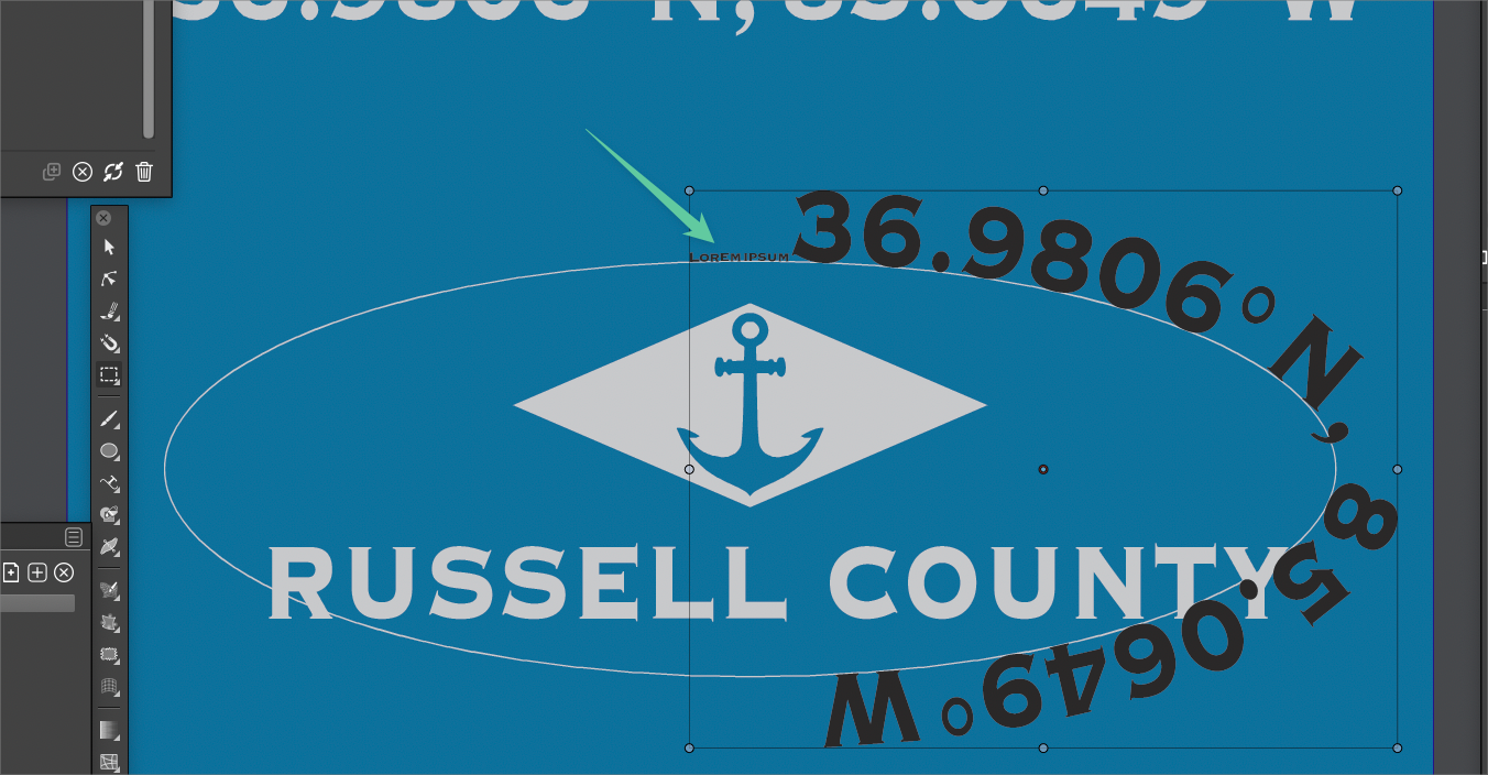

After clicking once with text tool to create temporary highlighted text, pasted text should replace it
I noticed this first when i was trying to pasted copied text into a text on a path temporary text selection, but it also has the same issue with regular highlighted filler text. When we click once with the text tool(whether on a path or normal text) it creates the temporary "Lorem Ipsum" text and highlights it automatically. If I already copied prior live text to memory, one would expect then hitting command-v would replace the highlighted "Lorem Ipsum" text with what is in memory - but it does not. instead it pastes it next to it.
Could this be changed in a future release of VS?

@VectorStyler Restarting VS and using a fresh document did not fix it here. Could it be related to my custom preferences? @b77 are you able to replicate the issue on your mac?

@VectorStyler I tried using the menu instead of the keyboard shortcut this time. I clicked once with the text tool to get the highlighted "lorem itsum" and used the edit>paste. It appends the copied wording to the end of the "Lorem Itsum"
I also tried "paste inside" and that did not work either....
@Boldline Then some settings is the issue, as here (version 1.1.046) seems to work fine.
@VectorStyler I am using the newest build, (version 1.1.046) as well. I set the preferences back to the default and restarted VS and tried again with the pasting shortcut and also with the edit>paste and it worked correctly both ways.
