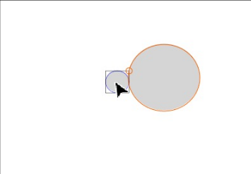

    Beginner's question here, how do you flip the choice of the collider tool to the other side of a line ? It always seems to be on the wrong side for me πŸ™‚
    I thought shift or command might be the answer. - or even coming in from the other side of the line ?

    I never really warmed up to the Collider Tool. Can't find a Key to flip.
    But if you take your Shape in the middle, and move it, you can easily
    control which direction it snaps to.

    @Igull Press the "space" key to flip path the side

    OK, got it, thanks !
    However πŸ™‚ You have to give the spacebar a short tap to get it to change - if you hold the spacebar, it rattles back and forth between the two rather than staying put - I think that needs fixed ?

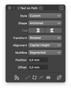

  • @Boldline In the 'Text on Path' panel (Text menu > Panels > Text on Path - Ctrl-F) you can choose from the different options of the Alignment menu:
    You can also select the path and reverse its direction (Ctrl-I), which will move the text on the other side AND at the other end of the path.
