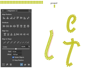

    I just managed to get this result, do you have an idea how to prevent that order switching while clicking again to move? I tried that 3 available options but without luck.

  • @Subpath Here is my collision snapping result
    It's hard to operate, there are no clear indicators what is selected (as at the beginning of the video). Can't see any TOOL highlighted while in the "colliding" mode.
    Never sure if I'm in a state where I can move things along the path or not. Sometimes the order is switching, sometimes the groups lose their connection and only one is moving 😕
    The Rotate Objects checkbox doesn't seem to work, unless its state is determined right before making a whole selection for collision. I don't know.
    This thing needs more visual cues, some kind of HUD or more prominent icons with the current state.
    Also I have no idea if these issues are caused inside that procedure or something else influences the whole operation, BECAUSE there are moments when it does work as it should.
    I have a feeling that all these icons need to be reclicked even if they're already highlighted, to get the desired effect.
    Here is the 0_1656802753134_snap-collide-test-v1.vstyler VectorStyler file to try.

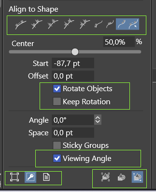

    @plrang Got it! But this is not Collision snapping. This is the Align to Path feature.
    The tool only works after an alignment to path is made. After the selected objects are aligned, without changing the selection, the tool can be used to shift the aligned object along the alignment path (no collision is detected here).
    Yes, rotate object (and other options) must be set before the alignment is made.
    The steps for aligning along a path:
    • select the objects first and then add the path to the selected (Shift+Click). It is important that the path is selected last.
    • adjust all the options in the alignment panel to the desired value.
    • click one of the Align to Shape modes (except the last icon).
    • use the align to path tool (the last icon) to adjust the object locations along the path.
    I will try to add more visual cues.

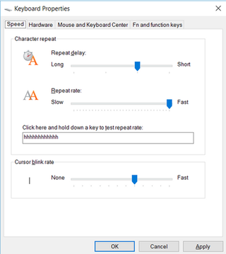

    Regulary i move the Shapes by changing Values in the Start Field.
    ( Put the cursor in the Start Field and press the UP or DOWN ARROW.)
    And i have always set my keyboard refresh rate in Windows high
    for all kind of texts. This speeds up value change also when i use
    the UP and DOWN ARROW buttons.
  • @VectorStyler So I merged those two features into one while working with the align to shape really, got it.
    It doesn't store its state. Not a problem with some simple patterns, but it may get difficult with more complicated ones.
    Would be much easier to work if the state would stick to arranged already elements.
    But if you don't plan that, it needs some persistent indicators like those in Transform tools . Currently, I believe there, is just a tiny rectangle around the objects and going back after some time to editing the setup is a challenge.
    And more clear button highlights in the alignment panel.
    Because the panel keeps a kind of a state which IMO is misleading.
