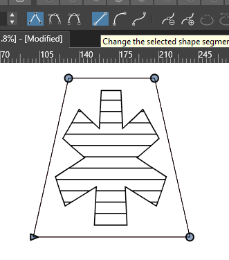

              • Select OBJECT > OBJECT OPTIONS, CLIPPED EFFECT FRAME
                and in my case...
                Set segment nodes to STRAIGHT 0_1658419980018_2c8d6419-0688-457f-befc-f128e0b1b996-image.png
            • Distort using segment node corners
            You guys (and VS) are awesome, Thanks.
