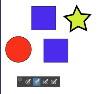

        some other Picker Tools are here, but dont know if these are helpful for your case.
        From left to right:
        Style Picker, Shape Picker, Image Effect Picker, Shape Effect Picker.
        Here a short video how you could use them:

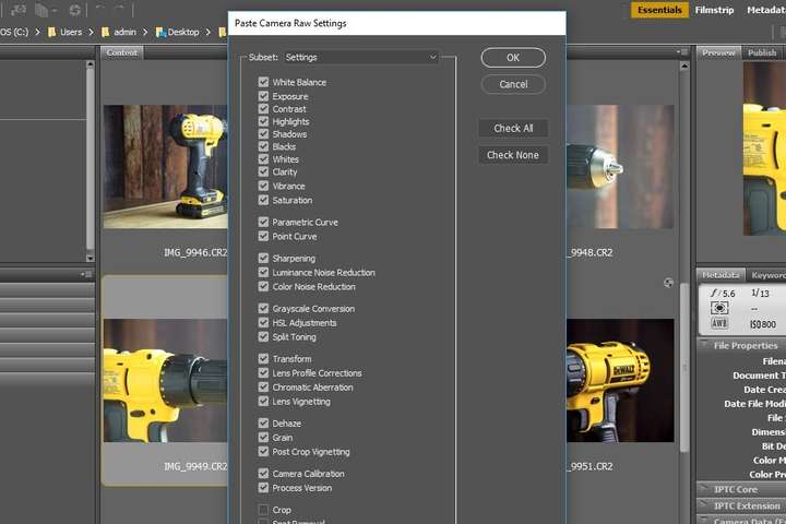

          This is how RAW development software works, when you want to copy and paste adjustments from the previous image, but not distortion, color profile, micro contrast, but otherwise the rest. And it works fine.

            Like this - but just simpler:
            Of course, you should be able to paste all or some of these subsets with the existing keyboard shortcuts alone.
            However, I'm thinking that @vectorstyler can't paste multiple subsets of atributes at once.
            Of that is the case I will recommend an additional paste submenu at right click, where you can choose from a list of subsets: image effects, fill and stroke etc. so you only paste one at a time.

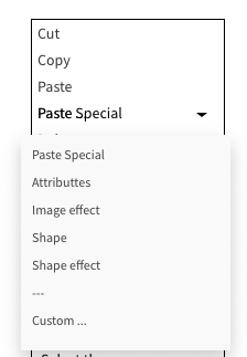

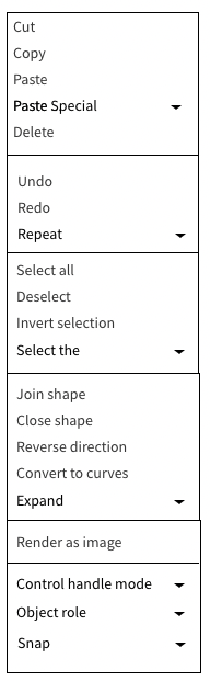

                            @VectorStyler Here is a little mockup of how a paste styles/attributes/whatever menu could work.

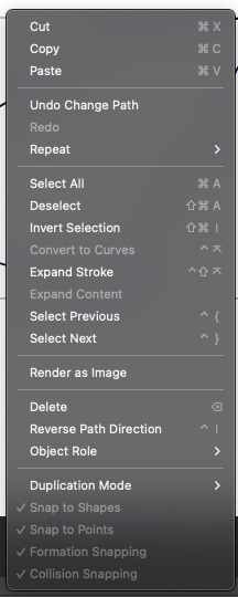

                            While I was at it, I made an example of how I would have set up right-click menus, the example is a remodeled "Right click path with transform tool" menu. I've left out some things I don't think belong in the menu. I kept Undo Redo Repeat, but I never liked them there. Perhaps non-mouse users do. I would removed them until someone actually asked them to be there.
                            I know your right click menus are really really dynamic - but this is just inspiration for how to group contents and in what order.
                            This link goes to an interactive model:
                            https://wireframepro.mockflow.com/view/vs-paste-object-attributes
                            Below are the two menus:
                            A an example of a paste custom range of attributes dialog will follow.
