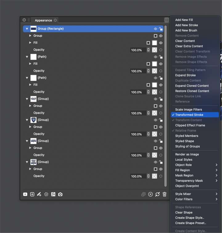

      I'm trying to scale these designs and I'm getting issues because the stroke stays the same size even as I shrink the design. When I go into the appearance panel, I assumed going to the main top group that represents everything inside and changing it there would have a cascading effect on all the sublayers under it - this did not seem to be the case... so instead I need to go seek out any and every stroke I want to scale with the design and adjust them individually.... this does not seem like the most efficient way to do this...
      0_1658514150327_66c6f405-d086-450f-a2d0-3879298cf5d5-BLD 2022-07-22 at 14.19.13.png

          @Boldline said in Can Scaling stokes and effects be on by default? Can we make it easier to switch all child sublayers by editing the setting at the parent level?:
          The Transform Stroke option set on a group (or layer) works for all child objects also.
          I add the default mode to the backlog.

            @b77 I had not thought of that possibility - thank you for explaining. It's possible I might change my workflow to utilize that.... it's happened with many other things that were done differently in VS than I was used to lol
            I got it to work now even when selecting the group it's contained in.

                    @Boldline One thing: if you enable "Transformed Stroke" in the options of the top layer, then all objects inside will have transformed stroke.

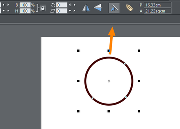

                      Magix Graphics Designer have a Toogle in the Context Bar
                      once set Strokes will be scaled even if you close and restart
                      the Program

                                Here a Pic:
