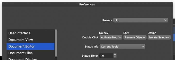

Probably related to my "what to do with an object when double clicking" settings.
Bingo.
@VectorStyler When Activate node editor is selected in Double click - No key is selected, the problem happens. If I set it to isolate, it does not. So it is a side effect of that setting.
@Ingolf said in Double clicking gradient handles should not do anything:
Yes, this could be a side effect. I added this to the backlog.
