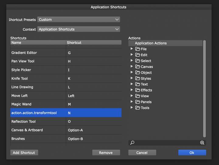

          • IgullI Offline
            Igull @VectorStyler
            @VectorStyler said in Strange Keyboard Shortcut Issues:
            @Igull All work here except "A then C"
            I open a bug on this one, but it could be a simple keyboard shortcut customization issue.
            I may have accidentally found the issue, within the keyboard shortcuts - application shortcuts context, I found an action.action.transformtool - allocated the letter N so removed it. Problem is now resolved.
            I've seen this action.action.xxxxxxx entry style before - and removed them, but didn't see this one.
            Perhaps @VectorStyler can enlighten what this is ?
            Neil
              VectorStyler @Igull
              @Igull said in Strange Keyboard Shortcut Issues:
              Yes, I found the issue. this will be fixed in the next build
