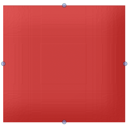

Bevel is completely broken (Image effects - Stylize)
Windows
macOS
@Ingolf Could not replicate here, tried both Windows and Mac.
If there is a sample file please send it to me by email. Thanks!
@VectorStyler said in Bevel is complete broken (Image effects - Stylize):
If there is a sample file please send it to me by email. Thanks!I see it at any time on any given machine or object
can comfirm this on win 10

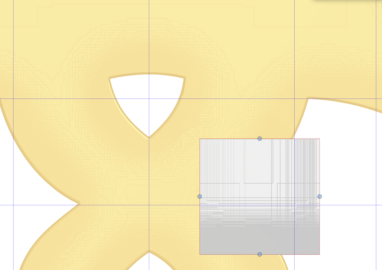

looks like a kind of low resolution Bitmapssee Pic here with Bevel
Same results here.

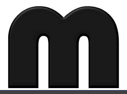

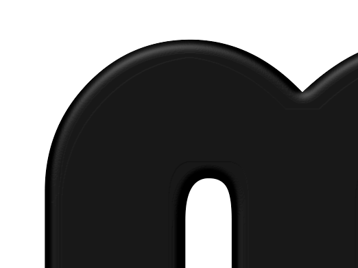

I don't need bevel for anything here and now, I was just on an adventure, so I'm not personally affected. But I get to it when I have to move into the intersection between vector and bitmaps, I can't live with the limitations of Affinity forever.
Until then, though, I'm strangely attracted to the patterns in that 'm', which evoke memories of a distant Commodore 64 era.
'Bevel' was always like this, and it's probably needed for compatibility with SVG (looks better when exported as SVG). So embrace it.
If applying slight blur doesn't do it, multiple Inner Shadows are needed to simulate non-pixelated bevel.

Well, i have seen better beveling.

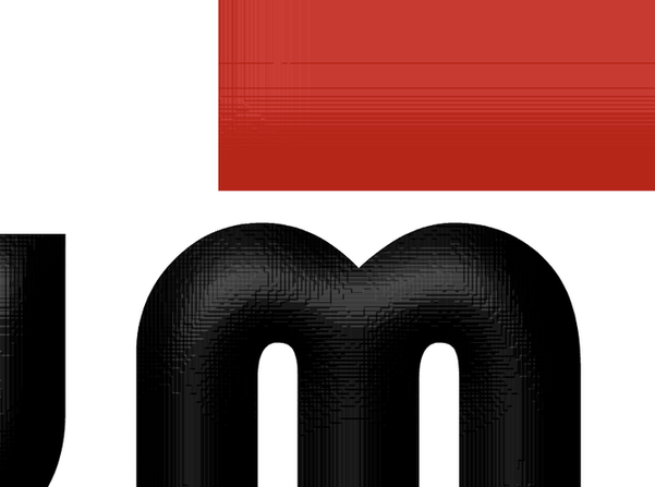

I see it as a weak point.I'm not necessarily need it actualy in VS.
But in the long term Vectorstyler could see if improvements
would be possible.It depens also on the zooming Level you use.
But can start to spot it at 200 %.100 %
200 %
300 %
@Subpath A4 100%
Clearly visible, weird and wrong.

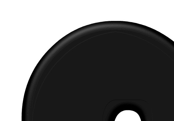

@Ingolf said in Bevel is complete broken (Image effects - Stylize):
Yes! And that's the kind of goodies you use bevel and emboss effects for in Adobe and partly Affinity. And that's... design!
but there is a price for it, with adobe (subscription)

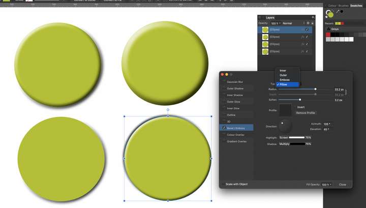

The effects you see in Affinity's FX and Adobe Photoshop since forever have been there for one particular reason: they're effects with which you can quickly create the real-world effects we know so well:
- shadow
 - inner shadow
 - glow
 - inner glow
 - 3D
 - Bevel and emboss
 - outline
 - gradient and color overlay
And THAT is why bevel + emboss is so important to me and others. If you're doing some non-flat design, these effects are critical and invaluable. I use them all the time.

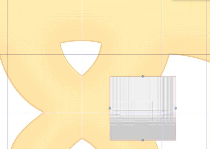

looks nice, thanks for the settings
but on the last O from the brown one
you could spot the artifact
(looks like a fine line inner circle/shape)
