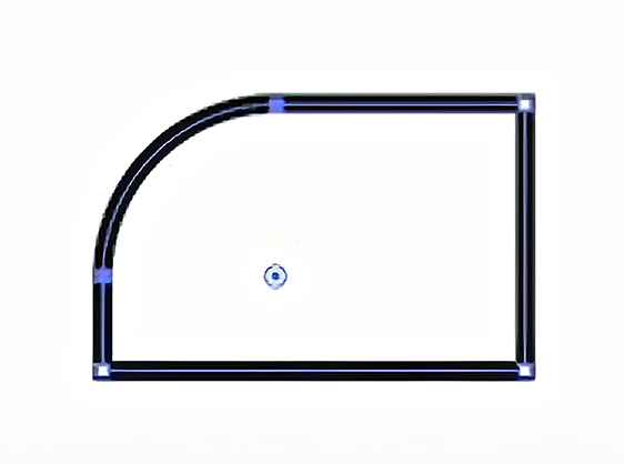

    No. There can be many similar controls in play, they can have different colours + another colour when selected, and if we imagine a scenario where work is being done in a colourful detailed design, then it all gets lost in colour. I definitely think we need a symbol here.
    Serif chose a nasty little red circle as they seem to work in microscope with their love for small UI elements, while Adobe for once has hit a sweet spot that I recommend following:
    Or resized:
    Video of Illustrator and corners (YouTube)
    I definitely find Adobe's corner tool the nicest to work in of all the programs I've tried. The results are excellent and the user interface is simple and unobtrusive.
    So if in VS we have a circle and Adobe has a circle, there's no reason for VS' to be any different if all it takes is a little dot. It also makes it easier to understand for people coming from Adobe.
