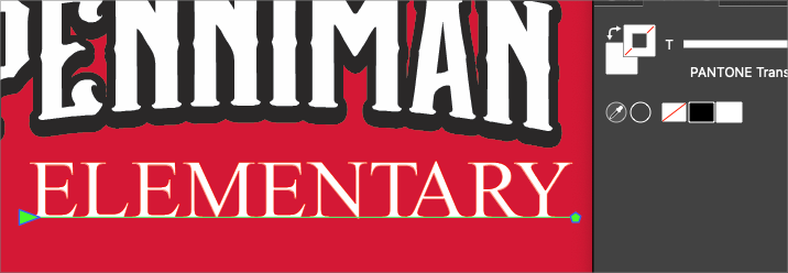

      Is there a reason the stroke color always seems to be the in the foreground by default?
      Nearly all the time, when I want to change the fill of something, I select it and the stroke is always the active option in the color panel and I end up clicking on a color I want to swap the fill to and it always of course, adds a stroke in that color instead and then I i have to go in and swap the colors and remove the stroke - this gets frustrating and time consuming... is there a way to switch this so the fill is always the default active option? This was also a headache for me in Illustrator.... so it's not a new thing to me...
      I keep thinking there's probably an option using a modifier to let the color the eyedropper is on be either the fill or the stroke automatically. Is that correct?

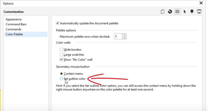

                              In the meantime, I also found information that the mechanic in question is available in Corel Draw. I don't know if in the latest edition , but up to version 2021 it is possible to enable it.

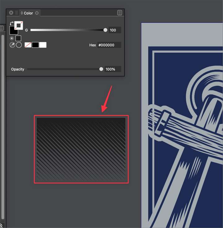

                                      I think I've figured out part of what was confusing me enough to lead to my original post in this thread - Sometimes I am importing a vector object and I assume because it has a fill and no stroke for example, that the fill therefore will be highlighted. Like in the example below (the screen capture could not capture both the color panel and the selection box around the shape below it)
                                      I pasted this vector group into my document and while VS acknowledged it was a black fill and no stroke, it did not move the fill box to the front as I was subconsciously expecting and so when I went to swap the color to gray, it added a stroke of gray to the black fill.
                                      0_1665716946194_a18092ee-e202-4620-ad64-d43741331f97-BLD 2022-10-13 at 23.05.46.png
