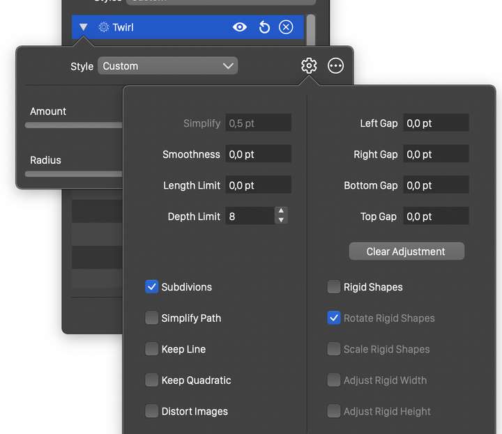

@Dazmondo "Distort Images" in the shape effects option:
@VectorStyler Thanks - I knew I'd seen it somewhere

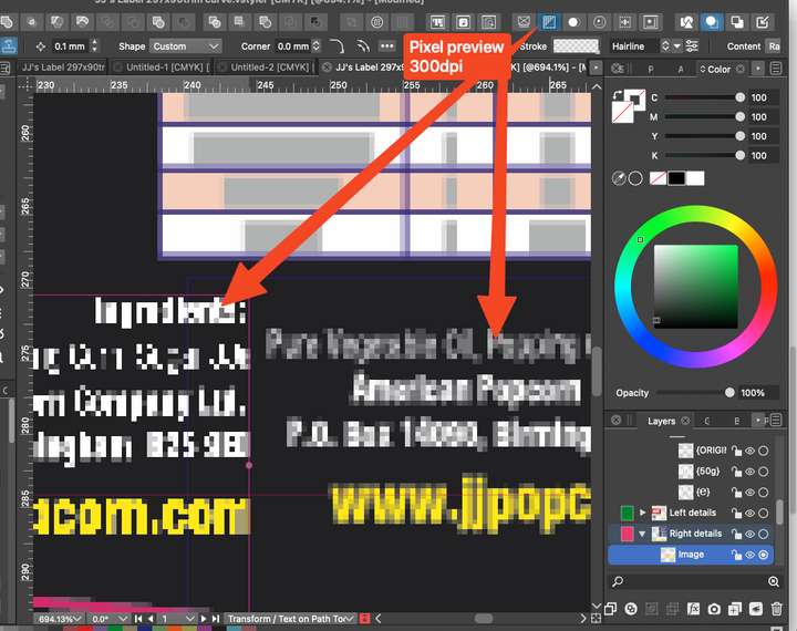

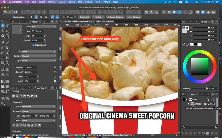

Is there any way of getting this to work in hi-rez?
@Dazmondo What is the distortion used here?
@VectorStyler It's Arc warp
@Dazmondo This can be replicated here also.
I will have investigate more to find out what causes this.
Added it to the backlog as a bug. -

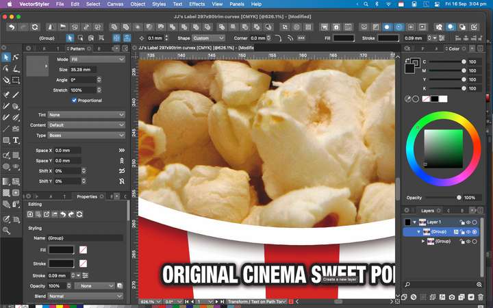

@Dazmondo Meanwhile, an other option for warp distortion is to use the Image Effects panel to create an image distortion over the whole vector / image group.
@VectorStyler said in Option to distort vector and raster?:
@Dazmondo Meanwhile, an other option for warp distortion is to use the Image Effects panel to create an image distortion over the while vector / image group.

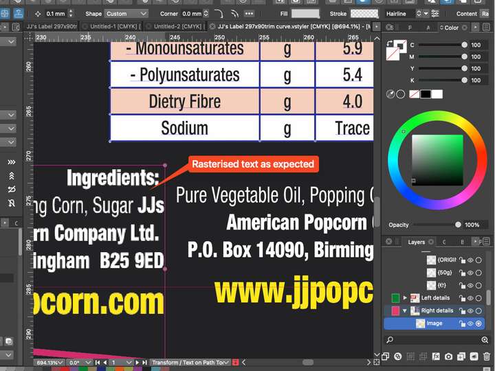

I'm assuming that would rasterise all the vectors on output?
Also noticed that pixel preview looks very low-rez
@Dazmondo said in Option to distort vector and raster?:
Yes.
