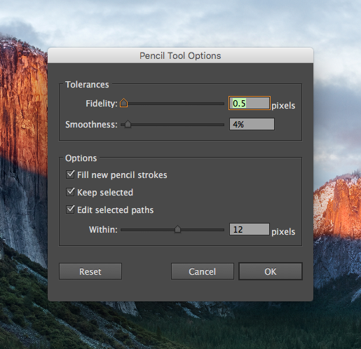

                                  On the general topic of what to expect from something named "pencil tool"
                                  It looks like we have varying perceptions of where the name meaning lays.
                                  In my perception the naming "pencil" doesnt describe the styling of the tool and that its exclusively drawing a stroke (after all its not simulating graphite or ink either) but a description of the characteristic of the way the user can expect to work with the tool, by which method the tool generates a curve which in the case of the pencil is in a more freehand manner as you do with a pencil. imagine youre drawing in the cmd Y outline preview where the curve generation of all tools are "naked" of how they create the curve. My understanding is that this is what is actually happening and the styling attributes is something that comes secondary on top.
                                  Ill also add that out from my reasoning one could ask, "but what about the "pen" tool then, its not descriptive of its how it works". I agree with this, its not descriptive. i would say from my perspective the naming of the "pen tool" in general in all apps is a bit misleading it should be called something more towards "plot tool" or "point tool" or something in that direction....but everybody is used to "pen tool" now which would make renaming such a tool hard now.
                                  i can see it from @Boldline perspective that the entire setting could be perceived as redudant. why have an entire checkbox for just limiting the tool to one type of styling. the styling can straight forward be set by the user in the fill and stroke box instead of changing the entire paradigm of the tool with a checkbox.
                                  on the topic of the locaton of the filled shapes setting
                                  • i agree having a tool specific setting like that it in the global program preferences feels a bit misplaced.
                                  • having it in the context bar is maybe a bit unecessary as you probably dont need that regular access to it
                                  • the correct place to have it would be in the pencil tool settings. when you select the pencil tool and press enter you get the dialog for the pencil and brush tool settings. this feels like the home for the allow fill setting. this is where i first went to looking for it and didnt find it.
                                  something like this

                                    Boldline said:
                                    Most users would expect this ability to easily use the pencil tool as a fill, as is already shown with @ncic .
                                    It was also the same expectation I shared when initially trying to use the pencil tool in VS.
                                    When you look at other vector editing programs, this is how it's handled.
                                    I doubt that most users expect this, or maybe I'm in the camp that doesn't expect this (see the 'real life pencil' explanation
                                    above) and thinks most users think like me.

                                    the correct place to have it would be in the pencil tool settings. when you select the pencil tool and press enter you get the dialog for the pencil and brush tool settings. this feels like the home for the allow fill setting. this is where i first went to looking for it and didn't find it.
                                    Placing this in the Pencil/Brush settings doesn't make it much easier to find than in Preferences, IMO.

                                      @b77 said in The pencil tool doesn't respect the fill and stroke color styling attributes set by the user.:
                                      @Boldline Which other vector apps have this approach for the Pencil tool by default (picking the stroke and fill of the previous object by default)?
                                      I stand corrected - Illustrator needs you to switch it in the pencil tool panel. Regardless, I agree with @ncic that it makes more sense to have this setting available in the pencil settings panel rather than buried in the preferences or taking up space on the contextual bar. If I was looking to edit the pencil setting to allow for an auto-fill, I'd be looking first in the pencil settings themselves.
                                      Personally, the ability to use the pencil to fill in space as you use it does not take away from the pencil name because you're still free-handing the overall shape.
                                      Speaking from my own experiences and from watching the methods of many vector artists via time-lapse videos, using the pencil tool with only the fill active is actually a very common way to get more natural feel from vectors. Many artists I've seen use it to ink their comics and designs. I would also agree however that most people doing engineering layouts and precise line work would not see much use from using the fill option on the pencil.
                                      I can see the value of what you're saying @b77 - about it having a default color and option that you don't have to worry about the color fill and stroke settings when you go to use the pencil - so I amend my view to suggest the setting be inside the pencil tool panel as @ncic suggested.
