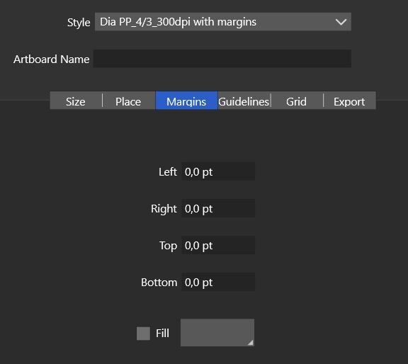

      I did save these settings with margins:
      but I can't see them and no data in the artboard options:
      It is a rather weird question but I wonder what could I have done to explain this ?

        @PatrickM Could be a bug. Looks like the margin settings were not saved with the document options.
        I added this to the backlog, and will try to fix it ASAP.

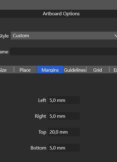

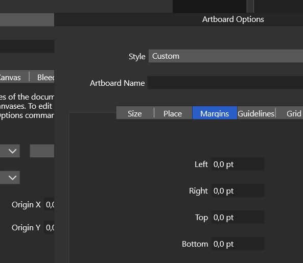

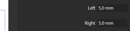

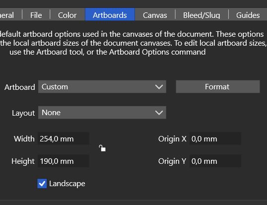

          @VectorStyler I've opened a file with margins (the one I've sent you):
          • if I go to File-->Document setup-->Artboards-->Format-->Margins--> I get "0 pt"
          • but if I click on Artboard options in the Context panel, I get the margins' values:
          I don't know whether this is related.

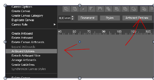

            VectorStyler @B-Vs-V
            @PatrickM Question regarding the margins in presets bug:
            where was the artboard margin adjusted? In Document Setup -> Artboards -> Format
            or from Canvas menu -> Artboard Options.
            because in the second case, sets the local artboard margin, not the document wide default.

                    One more thing to try: go to Canvas -> Artboard Options and select the margin there.

                          If I click on 'Artboard options' in the Context panel, it seems that I can only add margins to one of my two artboards (with the select tool selected).
                          I have then either to go to Canvas-->Artboard options, or by selecting the two artboards throughn the Canvas-Artboard panel.
                            @PatrickM said in Artboard margins, what did I do ?:
                            This one sets the margins of the current artboard. Use the pageup/pagedown to go to an other artboard and set the margins for that.
                            Another way is to select multiple artboards using the Artboard Tool, and then use the artboard options.

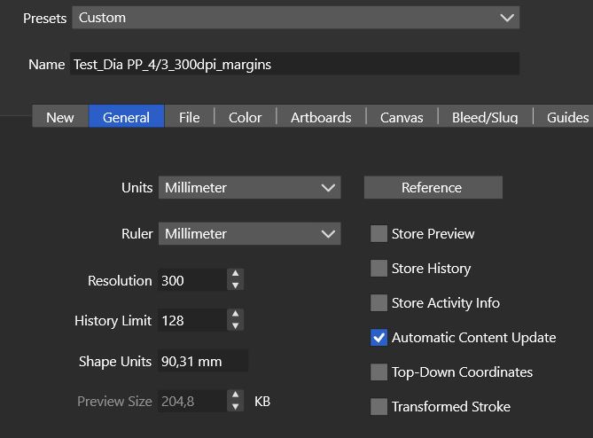

                              @VectorStyler This what I do/did and there is an issue (I think) with margins' preset:
                              1. I go to: File-->New document setup
                              By the way, I'm wondering what is "Shape units" and why this value of 90,31mm ?
                              1. I setup the document : 2 artboards & size of the artboards (PP 4/3)
                              So far so good
                              1. I then setup the margins : by going to Artboards-->Format--> Margins
                                and I create a preset with the ad hoc margins values... but when I create a new doc and want to adjust the margins' values with the preset, I still get 0. Or I do somethiong wrong or the values are not stored.
                                @PatrickM Can be replicated! will be fixed ASAP.

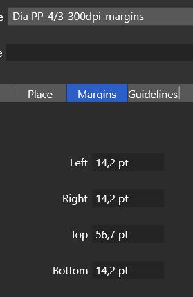

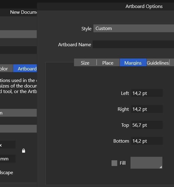

                                    @VectorStyler Fixed, very nice.

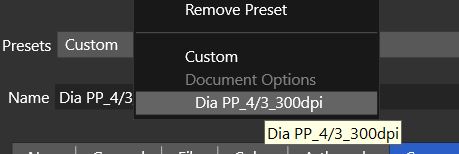

                                    I've found how to delete a preset (Preset Manager) but I can't found how to see margins values in mm when I setup a new document.
                                    When I setup a new document, I see margins values in pt. When I check in "Artboard options", I see them in mm (as I defined them).
                                    Not a big deal but I prefer to see these values in mm when I design a document in VS .
                                    Thanks.
                                      @PatrickM It will show in MM only after the document options are confirmed (which is a bit of a problem, since they are being edited).
                                      I will try to find a solution for this.

                                          A reset button is I think the best solution here.
                                          But, there is a solution already. Create a preset with the preferred default settings and then just select that from the Style drop down.
                                          B 2 Replies Last reply Reply Quote 1
                                          • B Offline
                                            B-Vs-V @VectorStyler
                                            @VectorStyler yes, indeed. It is even nicer to go by presets in VS.
                                            We would have to store a preset with '0' then.
                                            Edit : Done and it is fine. I always try to avoid using the keyboard when I can.
