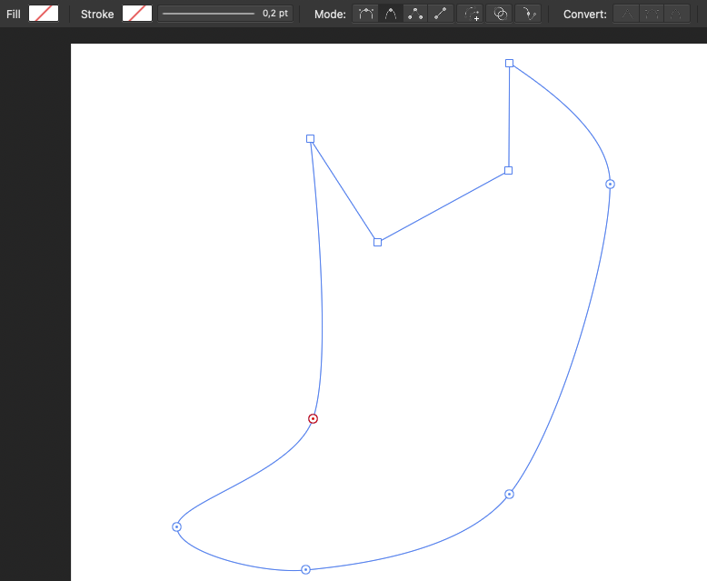

            @VectorStyler Just a little movie of smart nodes in Affinity Designer. As you can see this smartnodes and the algoritms behind calculates a smooth curve between the nodes as you draw. If you later move one of those smart nodes, the curve is recalculated. As you can probably imagine this speeds up handtracing and other workflows dramatically and it eliminates the issues with muscle strain I described earlier.
            I don't think you need to add smartnodes 1:1 - a new nodetype - I rarely use them for fine tuning - but the automatic calculation of the curves between points makes drawing detailed objects and especially detailed documents easy peasy and fast. The real and almost extreme value lies in the fact that you can draw hundreds of curves without the laborious and physically demanding process of dragging and clicking slowly, but simply clicking and moving quickly and easily.
            So I suggest a mode that when enabled works exactly like this and of course - when for example the Option key is pressed - draws straight lines.
            Affinity Designer smart mode / smart nodes demo (imgur.com)
